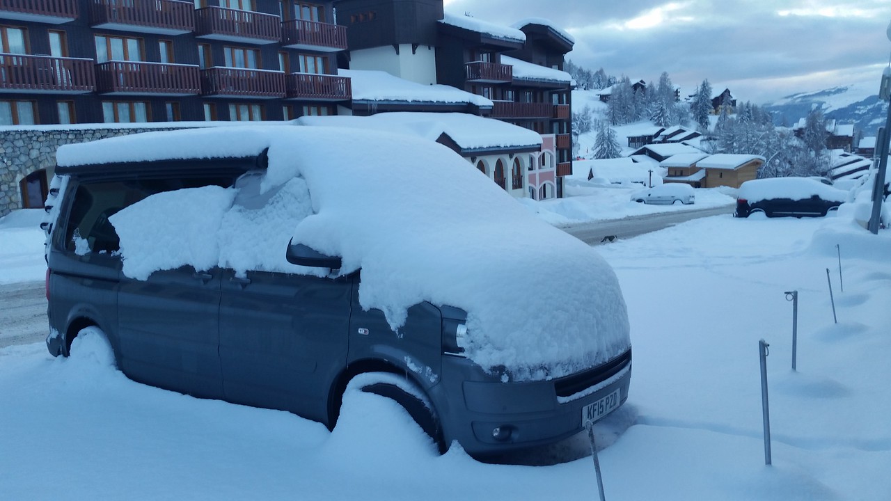

I got back from La Plagne in the French alps on Christmas eve. I was surprised by the difference the snow tyres made. I drove on packed snow, slushy snow, patchy ice and very cold wet roads and the van felt rock solid. A few sharp braking experiments felt as sure footed as dry tarmac. I bought 4 x Bridgestone Blizzak W810 205/65 R16 107 T C from Oponeo online and had them fitted locally to my "rattie" ebay 16" steels. I bought a set of chains to les Gendarmes happy but I never felt I needed them. Rims £50, Tyres £320 + local fitting.

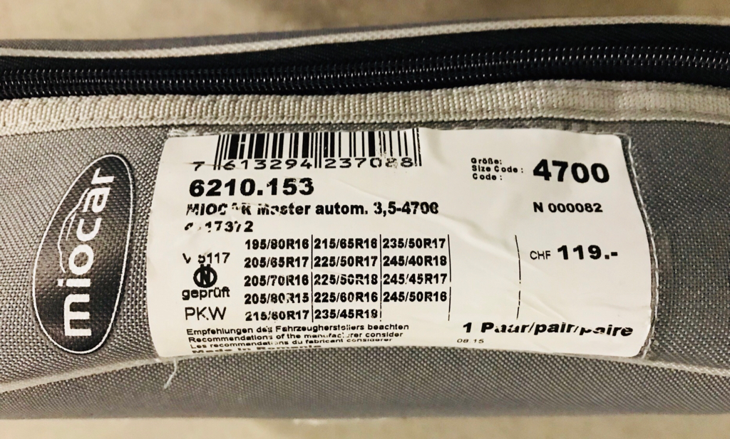

I would fit 215 wide for chains, clearance issue with 235's has been covered on the forum previously. On my T5 I have 215 / 60 / 17 winter tyres. Are you sure you have 15" wheels on a 204HP 4 Motion?
I would do as I did and buy chains in France. Carrefour in Cite Europe in Calais had a big range of sizes and prices as do most bigger supermarkets in France at this time of the year.

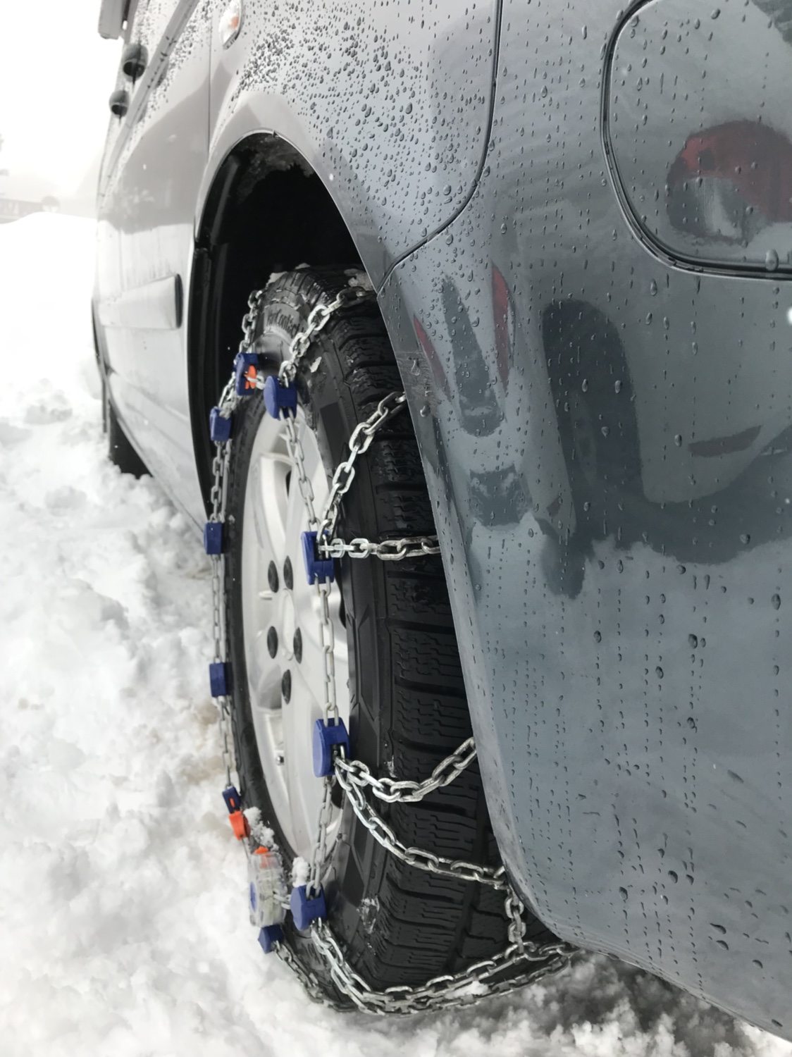

I am no expert however when you have the correct chain size, the chain never touches any part of the van. When buying (winter)wheels they often mention if they fit with chains (no problems so far). My chains are easy to fit and they stay in the same positionI hope they do not harm the tyres It‘s only allowed to drive 50km/h max.
I used them to drive uphill on a fresh slippery road (where you had to wear them/have 4x4) however I more likely used them to drive down to have some extra grip.
Sorry, a lot of guessing but to sum up: I am happy I have them with me in snowy conditions up- and downhill.

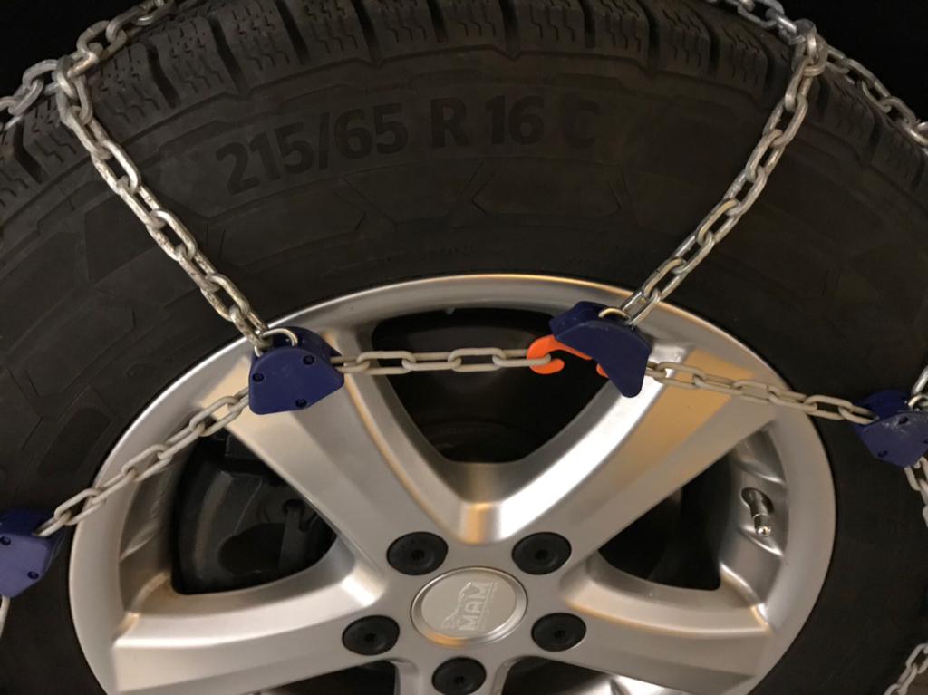

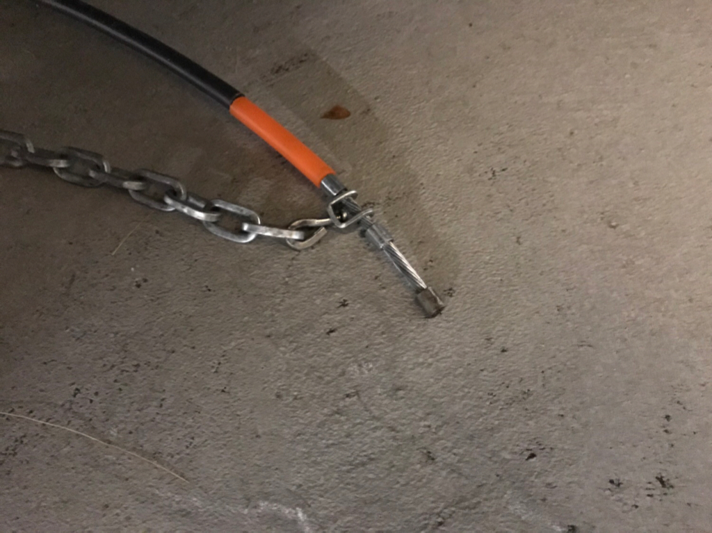

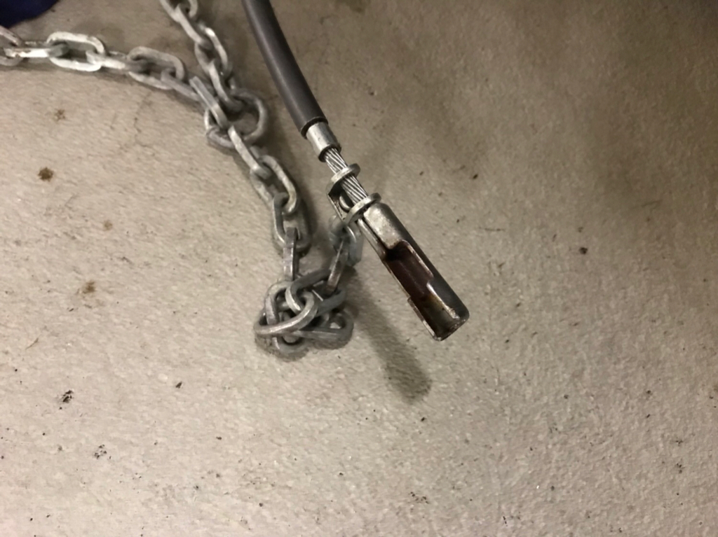

I tried them on again in the garage and found two parts which may cause some trouble:
Here you connect the chain together to form a circle. It is already rusty because of the salt I guess.
To put them on it takes about 5min (so total 10min).
Here‘s another point: It‘s important to wear the chains corrwctly otherwise it will touch the wheel and is useless (the blue parts should always be on the sidewall of the tyre)
And about price: They are okay to me but there might be cheaper ones.
