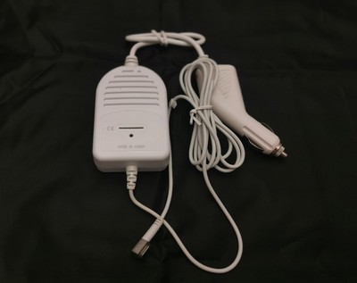

The charger I showed comes with its own MagSafe charging lead , the Magsafe 1 and Magsafe 2 to cover all Macbooks with the MagSafe charging port built between 2006 and 2017. DOES not require your lead.
My thinking was that it seems a waste to buy a dedicated 12V MagSafe charger now, for a Macbook that is already 5 years old or more. I'm assuming here that it's just for occasional charging in the van.

So the 12v charger comes with its own cable that would fit my Magsafe2 connection? Now I see.
