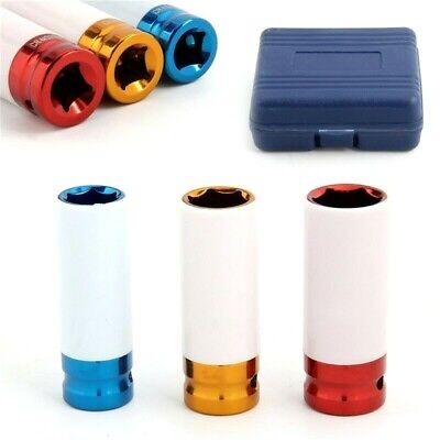

Like you I find the supplied wheel bolt tool useless for lock nut removal due to the angle which tries to spin the lock nut tool out/off the lock nut head.
I use a short breaker bar and wheel nut sucket which gives a 90 degree angle and have no problem removing the lock nuts/bolts.
This type. Use the 17mm on the cars.
