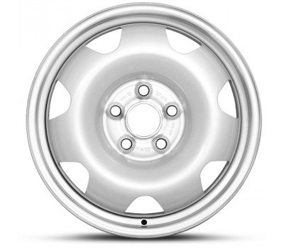

Hi, after a bit of a hair raising experience driving on snow recently I'm thinking of getting a set of steel wheels with winter tyres.
I have a T6 Ocean 150 4 Motion with 17inch wheels.
Can I fit 16 inch steels or do I need to stick to the original 17 inch diameter?
I think I read somewhere on here that the wheels have to be a certain size to accommodate the brake calipers but I can't find that post again!
16 inch wheels seem to be much easier to come by on the second hand market and the tyres are a bit cheaper too.
Cheers. Just had a look at the spare, it's a 17 inch like the one in the photo.
Stick with 17" then i would they look much better anyway
yes, I hit this problem a little while ago with my 2017 Ocean. The front brakes are upgraded, so the 16in steel wheels did not fit. I bought a set of 17in instead which are perfect.
