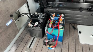

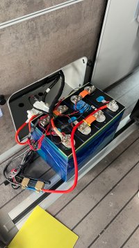

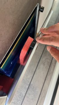

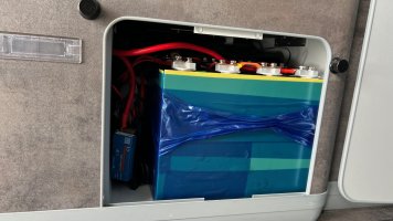

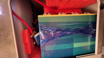

@akprincehbd thanks for the details. Still not quite clear to me how you managed to secure those batteries in place. Do you happen to have pics?
@yanathem the strap method is one I considered. This could work to secure a custom battery that replaces the existing one under the driver's seat (left hand drive van), but I couldn't see how to do something similar in the compartment under the fridge. Mind you, with a large enough battery, one is probably enough, but I have to see the space under the fridge wasted
My AGMs are on their last legs, so it's time for me to do the LifePO thing. I know how to put a battery together, but securing it in place is what has me blocked at this point

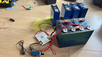

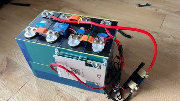

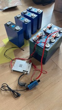

Yes thanks for the advice. It has to be very confident and professional, I'm a electrical engineer doing home offgrid conversions. Basically you just need to secure everything making sure there is no piercing or anything when emergency braking. The Epoxy fiber board surounding it should be at least 1mm thick.

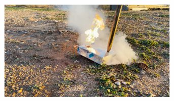

The EVs that caught on fire is mainly very strong impact with direct hit causing the battery pack to be deformed and then shortened. And mostly they were Li-ions rather than Lifepo4.
@Nand0 ye I can take some pictures later one when I got time.
If you plan to put only 1x 314ah pack (4kwh) I suggest to put it under front seat, it will balance out the weight a bit. 4kwh is already too good enough for most ppl usage
Much appreciated
I agree, 1x314ah would be enough, but quite frankly, given the prices, and that otherwise the space under the fridge would be wasted, I'd be very tempted to put a second one in there "just because"
What kind of "epoxy fiber board" are you using? I was thinking of using Bakelite boards, but open to better suggestions. I don't want to use wood like some people seem to be using.

If it were a Li-ion battery the resulting fire would be explosive and this is the battery chemistry those scooter and bike fires involve.
My concern would be with the BMS in DIY battery solutions. @akprincehbd what solution do you use for bms if adding the EVE cells in your Cali?
