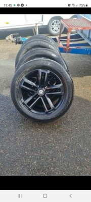

most use the ones off Amoraks.
direct fit, bit less offset.
Example set
Yes, had seen that - assumed that meant they were rated sufficiently for the CF. Was wondering about Touareg wheels too.
Amorak would be OK not sure about Toureg although get quoted as suitable.
LandRover ones are also used but need suitable bolts and spacers to compensate for different Offset.
Quite a few alternatives but care needed to check actual Load rating and offset Can't rely on some suppliers getting it correct.
