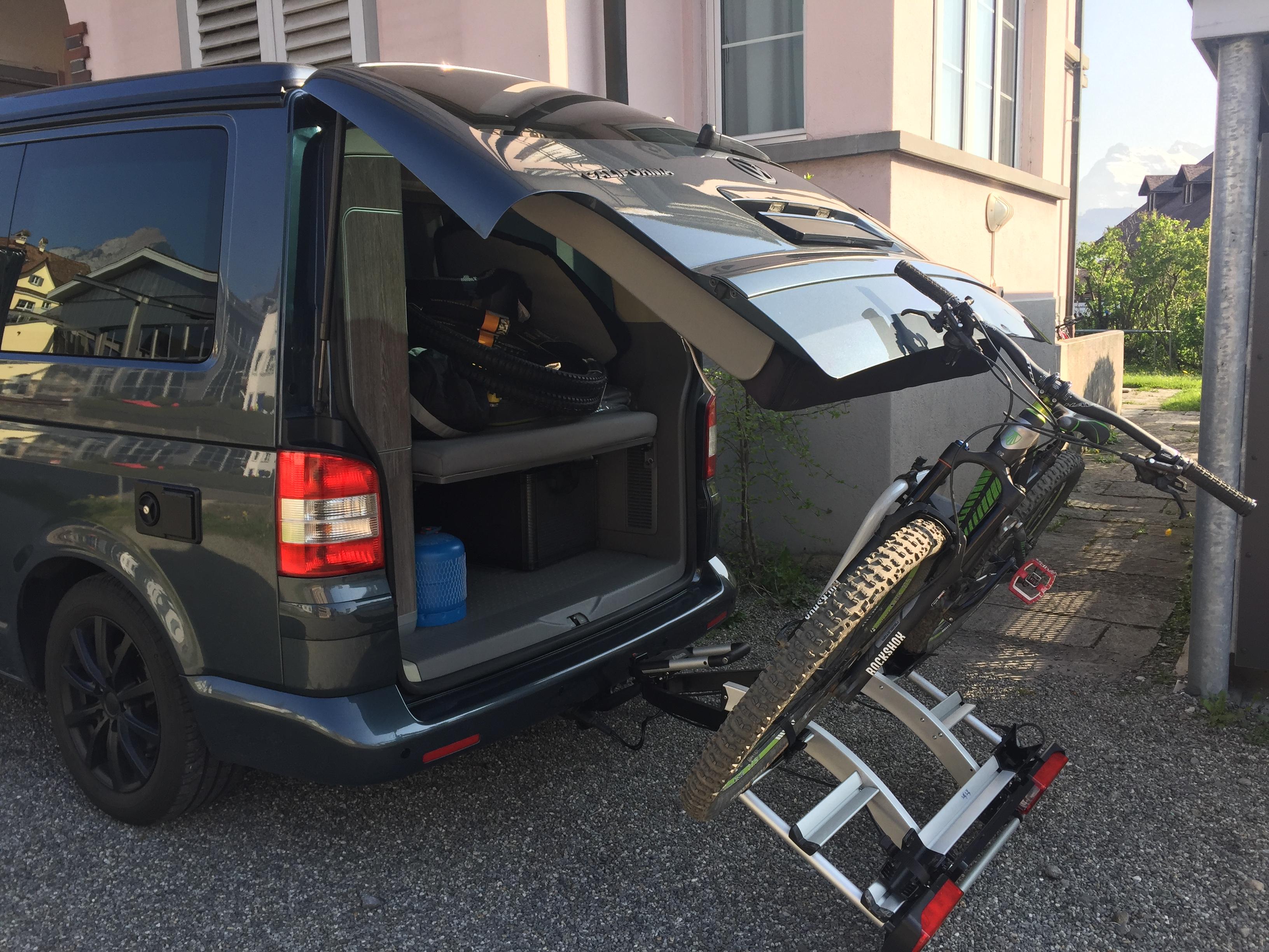

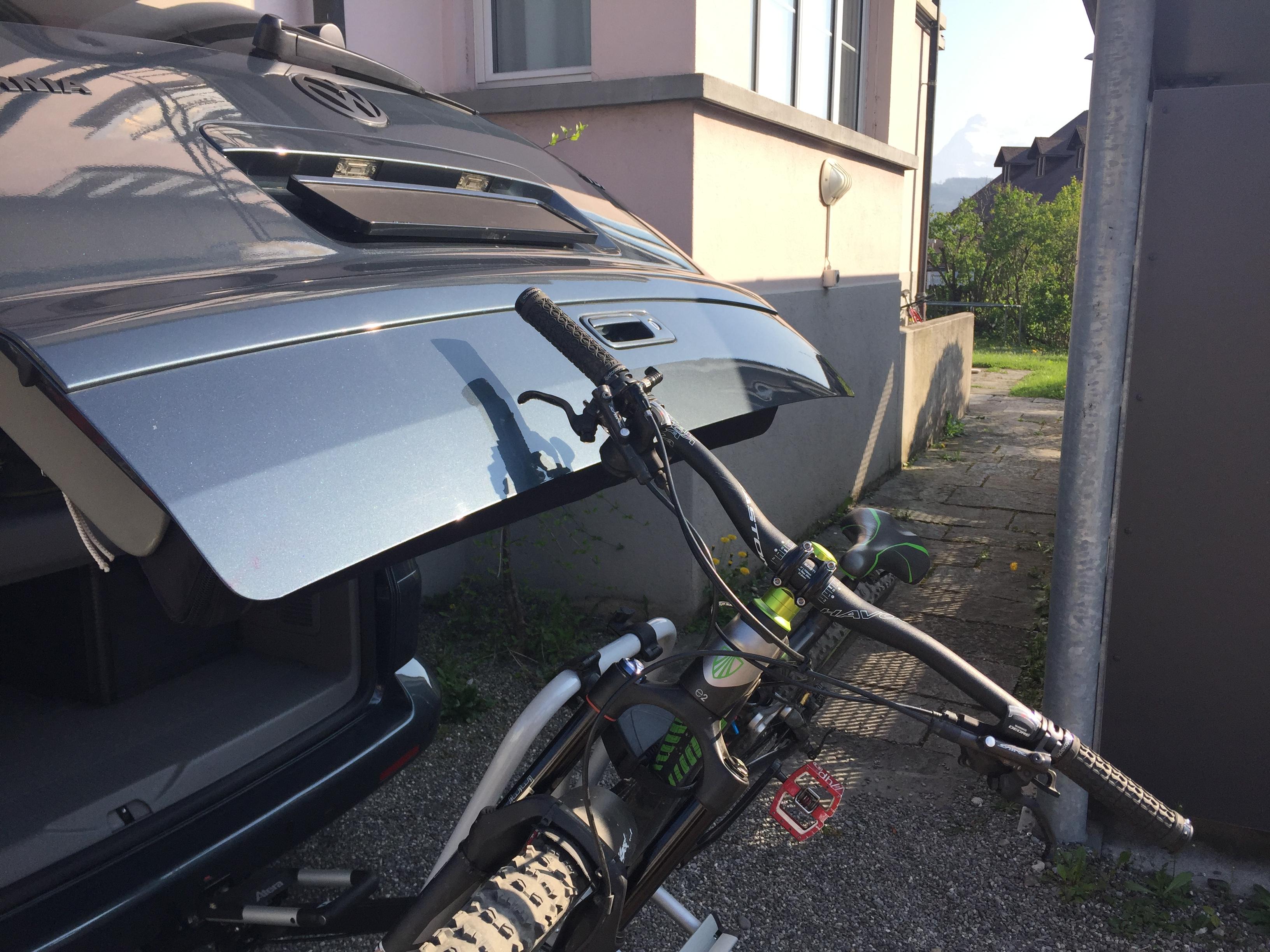

As above the Genio Pro does allow tailgate to open. Unable to post video but have photos of two bikes attached and in position for tailgate to open.
Looks like they fell off!!:cool:
And that would be impossible with a 3 bike rack (with or without 4th bike upgrade). The rack gets too long to tilt 90°.
For a 2 bike rack this would be ok, for 3 or more not anymore.
