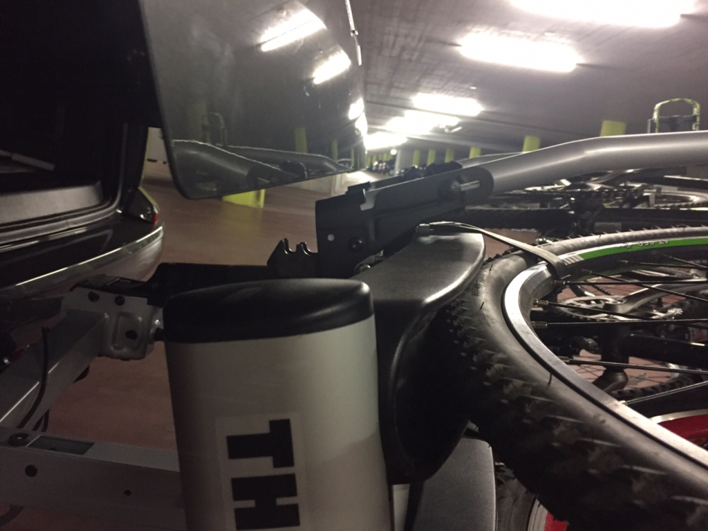

Thule G6 928/9
The tilt mechanism restrains the degree of tilt with a short wire cable. The position of the cable can be changed to allow the rack to tilt further than its default setting. It's a two minute spanner and allen key job.
This allows the rack to tilt almost perpendicular to the ground and allows the tailgate to open and clear the rack and any bikes fitted - without moving the handlebars.
There is plenty of room to stand in front of the rack and access the rear of the wagon.
Just a note to say that the bike is not not on the ground. I think that would be the same with three bikes on - but not sure (yet) about how it's be with the option 4th bike carrier fitted.
I hope the pictures help clarify it. There are other plus and minus points for both racks, but these are just opinions (which I'm always happy to share!!) and have been debated elsewhere. But hopefully this helps others who may, like me, be unsure of how each rack works.

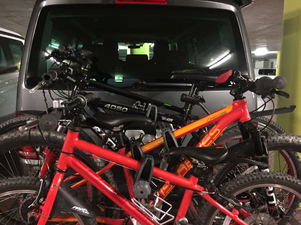

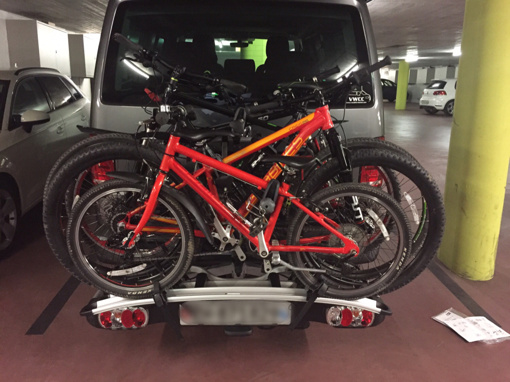

Just wanted to add our two cents worth to the collective tow bar mounted bike rack wisdom!
We're a family of 4, T6 beach with factory fit removable towbar (not UK!).
We were all set to buy the Atera Strada DL3 with 4th bike extension after reading all the relevant forum posts. But the place we went to had both the Atera and Thule G6 euro classic 929 in stock and were very knowledgable and let us try both. The salesman seemed to know his bike racks (and his customers) and recommended the Thule over the Atera for the following reasons:
- removable arms, therefore easier bike loading. (Having now used a couple of times, we appreciate this point!)
- sturdy grips that lock on to the bike frame (compared to straps on Atera. He claimed some customers have had their bikes stolen because the straps are easily cut. I found references in the marketing specs for a different Atera model stating the straps have a metal core, but could find nothing in relation to the DL2/3).
- the fixture over the tow ball on the Atera eventually warps/widens/loosens, thus requiring an additional shim. (This we could corroborate with a bit of googling on both English and German language forums).
We tried for a day to test and ended up purchasing the Thule with 4th bike extension and have returned from our first long distance trip happy campers/customers. :)
The Thule is heavier (17.6kg) than the Atera (14.5kg), but Mrs Swizzle was able to fit and load the rack singlehandedly no problem.
One of the most important points of course: the tailgate CAN be opened when fully loaded with 4 bikes!! :) As has been previously mentioned, there is a wire stop with two possible pin positions. Using the outer position enables the rack to tilt far enough to open the tailgate.
For travelling, we did remove the outer pedal and turn handlebars on the 4th bike to avoid touching the floor when tilted (we could still open the tailgate without doing so, but they would have then touched the ground). We also ended up rotating the handlebars on the other 3 (mountain) bikes, which made loading much easier and also avoided potentially knocking on the back windscreen over a bump. But again, this wasn't necessary in order to open the tailgate, more our cautious preference! It takes all of a couple of minutes to rotate them so not a big inconvenience for us. The spacing between bikes on the Atera is 18cm, compared to 22cm on the Thule, so Atera more compact but Thule offers more space for wider bikes, such as mountain bikes.
Pics below of our initial test load before purchase (unfortunately forgot to photo the open tailgate... you will have to take our word on that ;) will try to remember next time we have it loaded).

As stated this was not a necessity, rather our preference to make loading far quicker and easier (we have three mountain bikes almost the same size or with saddles in the place where handle bars need to go if alternating, so getting them on any rack would require careful alignment)! Not necessary at all in order to tilt or open the tailgate
Was a close call for us which rack to get, we saw both in action, went home again to research more and try before be bought. Happy with our decision, glad you are with yours
We'd read endless forum and internet review posts about bike racks and these points we hadn't seen raised before in relation to the Atera (specifically the potential need for a shim and potential bike theft) and it had also been difficult to find a definitive answer of 'does he Thule tilt enough?'. Hence the purpose of bothering to post.
@sapto it was this shop: dachbox.ch -
the Kloten 'showroom' is quite close to us.

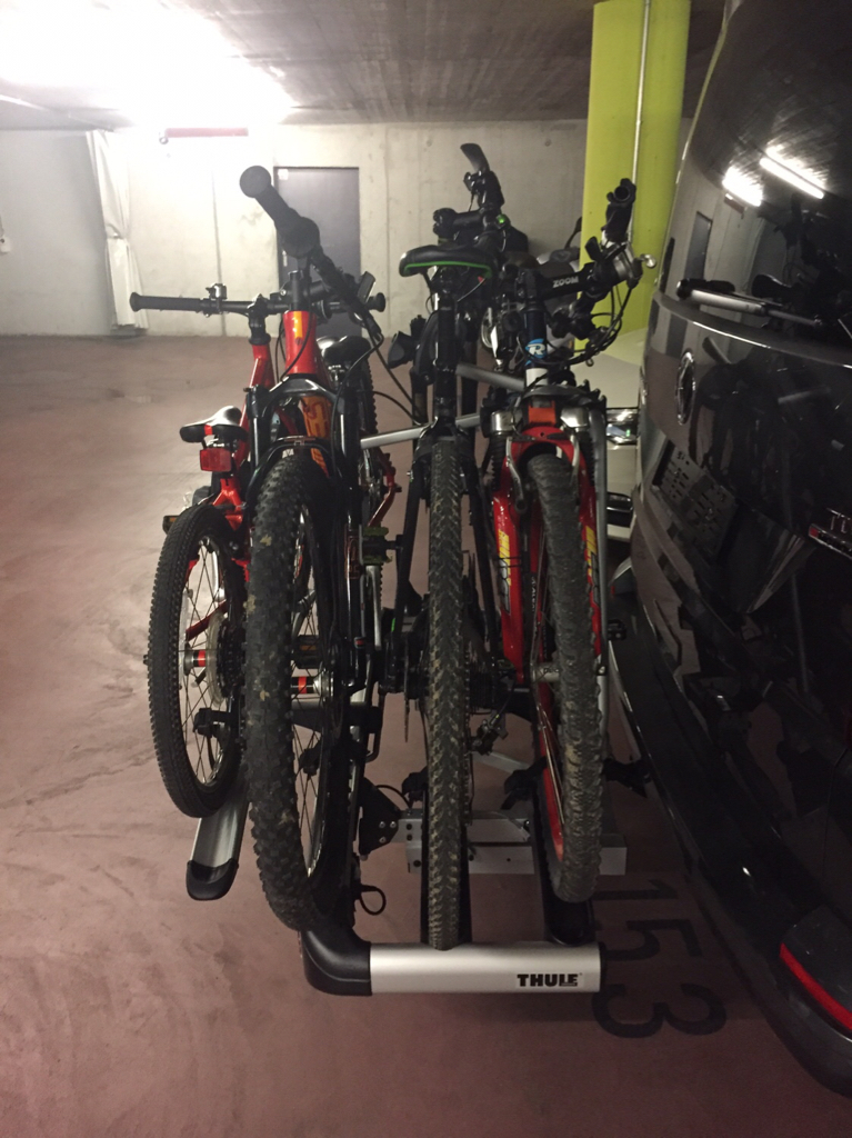

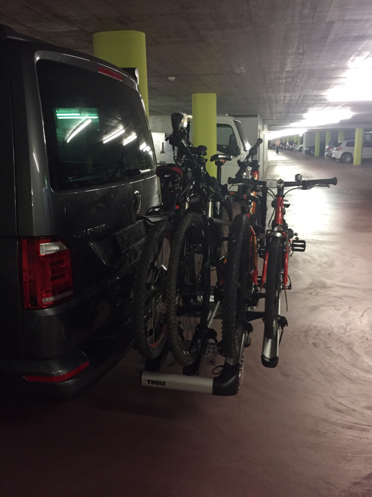

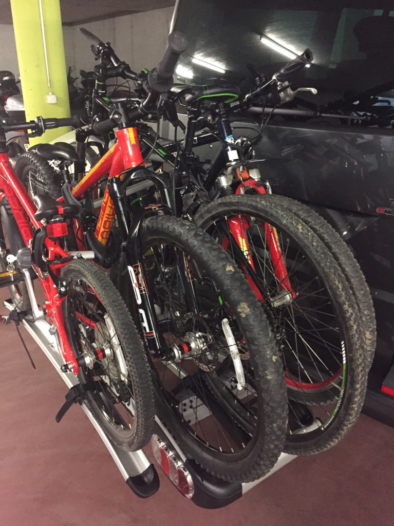

Headed out with our bikes again today so for completeness took some more photos of the critical points using the Thule Euroclassic G6 929:
It's possible to load up with no turned handle bars or saddle removal, though required some jiggling / Tetris tricks due to our current bike geometries. This is the primary reason we usually just have an Allen key handy and turn the handle bars, makes loading much quicker in our case! The only way we could do this with our bikes was having the inner bikes facing the same direction, but the 22cm distance between bike rails allows for rear wheel axles side by side... just.
Clearance against the rear windscreen is fine:

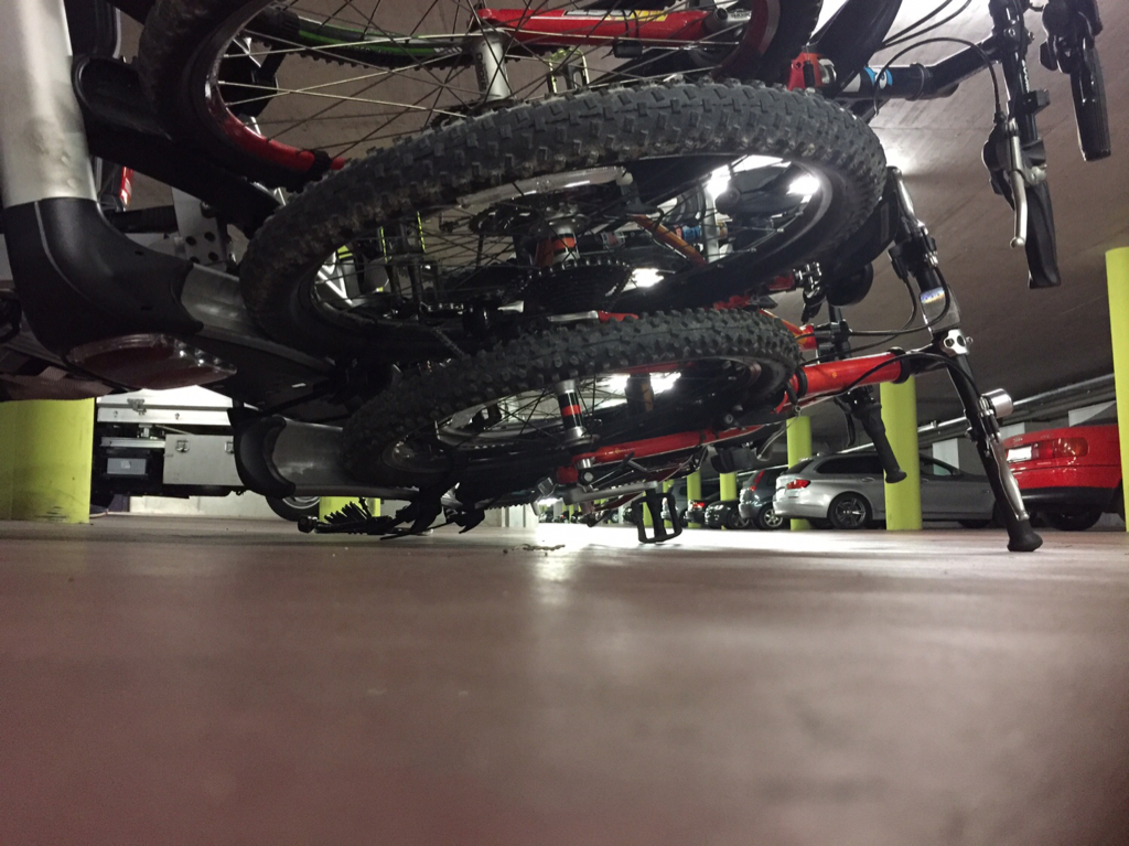

This shows the loaded rack tilted, BUT note the outer handle bar and pedal resting on the ground, so we normally remove the pedal and turn the handle bars on the outer bike. Not to everyone's liking, but in our opinion not a big deal:

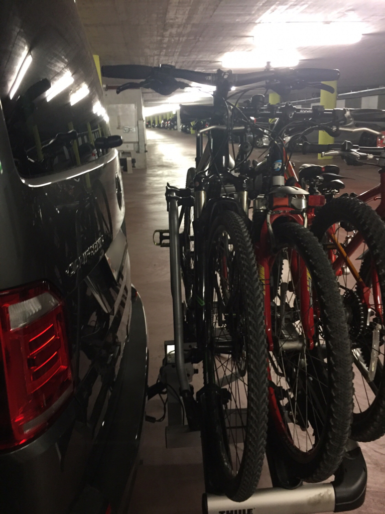

And the important thing for most Cali bike rack owners: clearance on the tailgate:
Hope that might be helpful info for others researching bike racks :)
Thanks - have you got the factory fitted removable towbar?
Yes... but it's a Swiss Cali in case that matters (it was suggested further up this thread that there may be a slight difference between the UK factory fit tow bars and those on the continent?)

This is really helpful. Thank you. I'm in Norway so can't get an Atera so I wanted to find a Thule, which are easy to source here. When you have the time, could you please post a photo of the new retaining cable position? On my 929 there are two holes, the one that it was fitted with and another that allows a bit more tilt. The latter does not end up with the outer bike touching the ground and more importantly, my T6 door doesn't quite clear the frame. Did you drill an additional hole? Thanks.
Hi California4x4.
If you look back at one of my posts earlier in this thread you'll see a photo with the cable in its new position. I didn't drill any extra holes, I simply moved the cable to the other available hole. It seems really strange that the clearance on all makes of rack seems to vary from vehicle to vehicle. As you can probably see from the photo, our tailgate clears the rack easily. The only difference must be the make of towbar?
