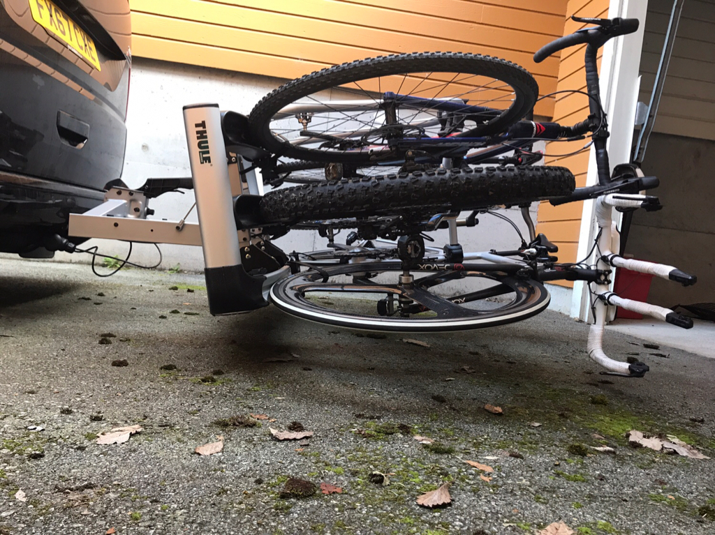

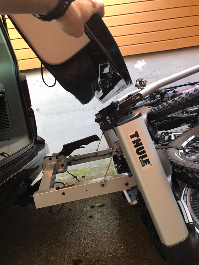

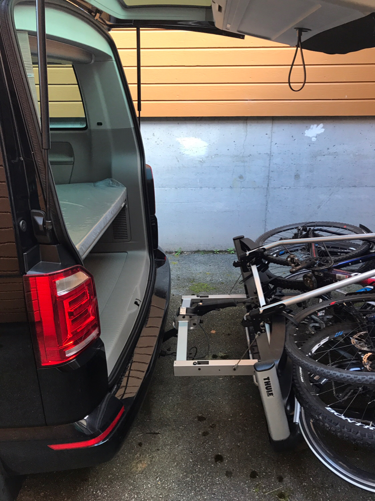

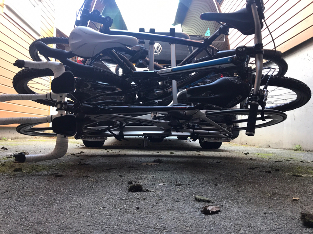

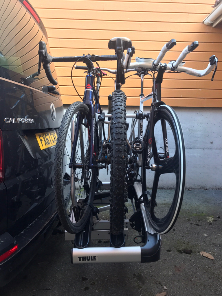

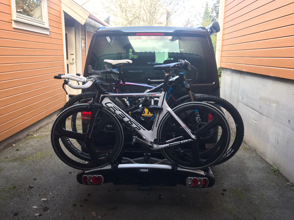

Experience with the 929 has been mixed. My first one (never a good indication) when I locked the clamping mechanism with the key never unlocked again. I’m please I bought it locally as I returned with it, asked them to order me a new one and then watched them dismantle the clamping mechanism to remove it. My second one (photo above) is working perfectly. It functions as I want it to, is solid in transit, and the locks are all working properly. Thule locks don’t have a good reputation after a brief google search.
