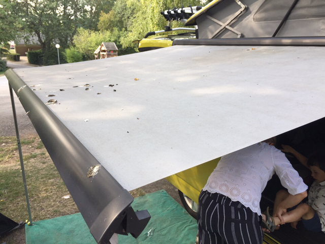

Covered with bird poo this morning.
Sh1t happens.
The problem is that you might not be able to remove it all and then it ends up on
the underside also, well stained a bit at least.
I have jet washed mine a few times and give it a spray with G101 first, its
possible to jet wash it without blowing it away.
