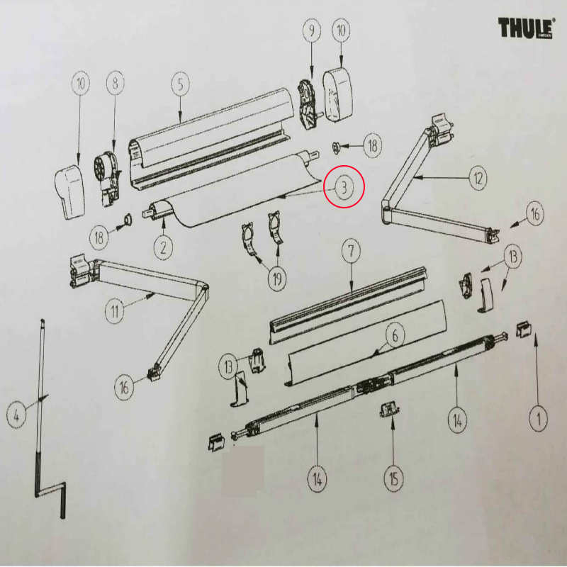

You can replace the awning material with a non-seam replacement. Forum shop sell that item.

My seam has just melted off in France. Van is 7 years old. We’ve managed to jam it back in but I’m not risking a repair. Has anyone done the canvas replacement? Can it be done with awning on van?
