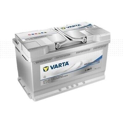

Hi @WelshGas,
Hope you're well? Just reading through this thread as I was trying to find out what capacity / size etc the Leisure Batteries are in my Cali (2016 T6).
Are both the Leisure Battery (located at the bottom of the cupboard) and the Leisure Battery (under the passenger seat) the same (size and capacity).
My system holds no charge anymore and think its in need of both replacing. I have the Solar Camper Solutions kit (https://www.solarcampersolutions.co.uk/index.php/en/shop/vwcalikit) ready to rig up so would sense to have x2 new batteries to go in at the same time?
Do you have any links / recommendations of which Leisure batteries to look at?
Sorry for all the questions - not only am I a complete automotive creation but also an electrically inclined numpty so good to learn and hear off someone who clearly knows what the hell they're doing! :-D

As above link supplied by @Ch1pbutty .
Both batteries are the same. If you can wire a plug you can change the Leisure Batteries. When you get them charge both up separately before fitting.
Yes, just a swap. If you dare tryn with solalr panels install first, maybe you can wait with getting new batteries.
