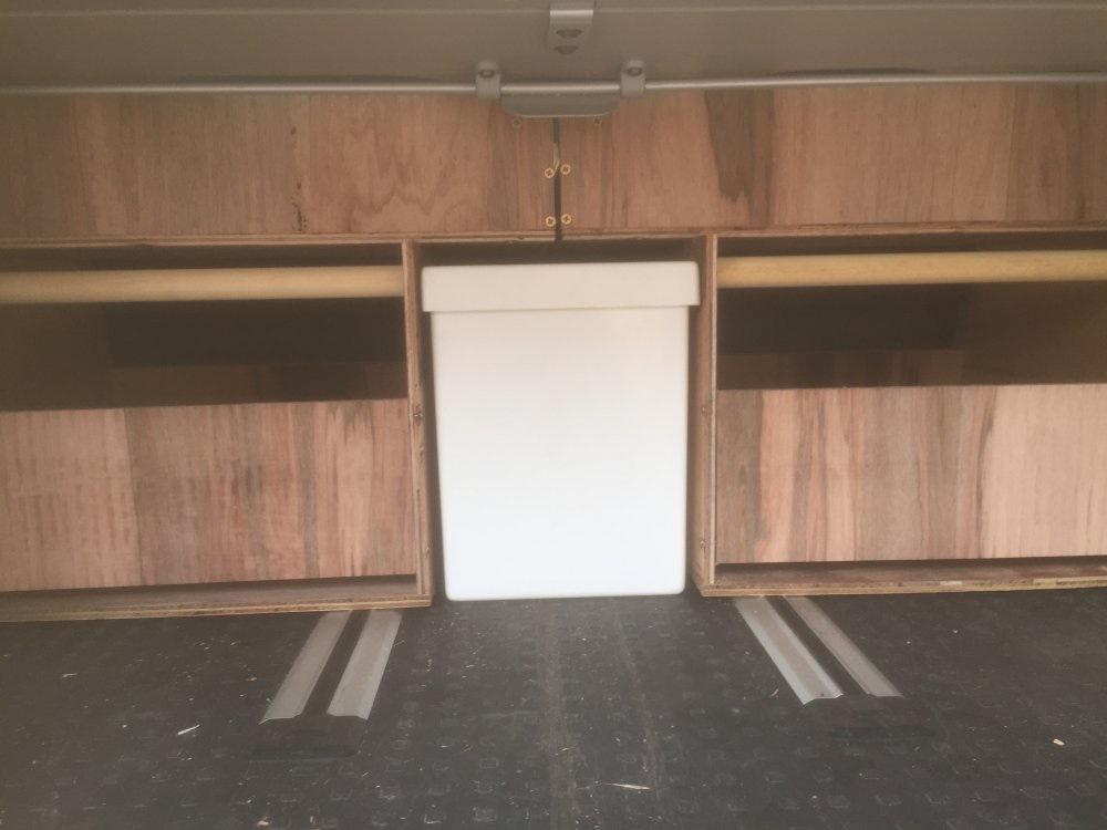

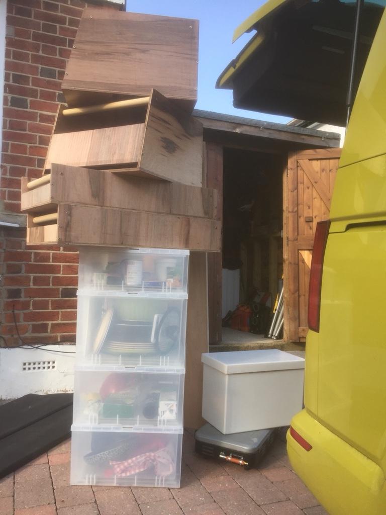

I have three boxes that slot in the gap between the multiflex and bench positioned to fold into the bed. They are easy to retrieve when the area under the multiflex is clear. They are also sufficiently low for the bench to be folded down with the boxes in situ.
On top of the three boxes can sit two shallow boxes that I made that span the entire 150cm width of the boot. They sit level with the top of the multiflex.

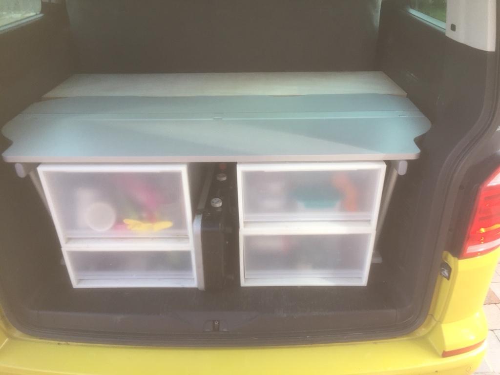

Under the multiflex there is space for four Muji drawers.

With pleasure.
All the above fits below the level of the multiflex parcel shelf.
The four plywood crates and the fibreglass box sit between the multiflex and the bench seat.
The four Muji drawers sit under the multiflex and the gas cooker slots between them.
A plywood board sits on top of the four plywood crates exactly level with the multiflex.
