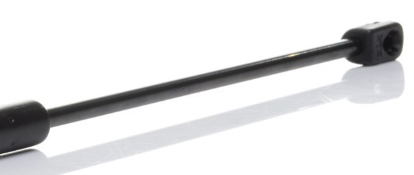

Does anyone happen to have the part number for the VW updated 1270N struts please? (Or are they1250N?)
I ordered some ‘uprated’ ones from SGS but user error (and the fact that Cali ones aren’t listed on the website at all) mean I got some weaker ones which I’ve sent back. I spoke to SGS but they said 1250N was the maximum available for this replacement strut and any higher requires a different kind of strut.

The SGS ones also had a different style of ball joint, which seems more fiddly- see below:
I would also prefer the OEM style ball joint too (as shown on the SGS website but not what you actually get):
At this point, just having the tailgate not break my legs would be a luxury, let alone lifting it with a bike on it.

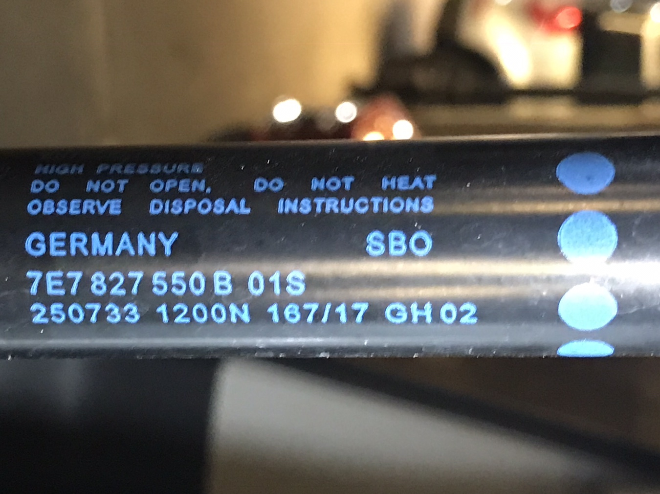

Part Not 28

@WelshGas, thank you again- is that for the T6? Would’ve taken me weeks to find that. Typed into SGS and came up as T5 so will give them a shout.

Unchanged as far as I am aware. That part number was for a 2016 model, so T6.
Thanks @WelshGas , I’ve googled that part number a lot now and maybe the diagram architects didn’t update the part number as everywhere seems to think that is a T5 strut with a length of 755mm vs my part No. for the T6 with a length of 711mm. (Perhaps VW changed the mounting position hence the reduced length?)
Anyway, googling my (T6) part number 7E7827550 brings up the strut with varying eject force ratings and the 1270N always seems to be; a) expensive and b) out of stock.
The plot thickens, will let you know what happens.
Thanks @Loz - same code as mine so I’m guessing the suffix ‘A’ denotes the 1270N
