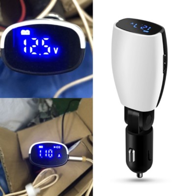

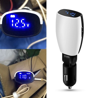

Also get a cheat plug in Voltmeter to plug into one of the 12v sockets in the rear to see what the Leisure Battery voltage is doing.
