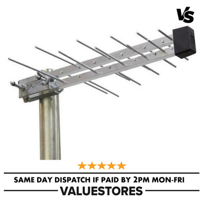

What's with the aerial? Is good?Ben Nevis Holiday park this morning, Bertie felt a minority.
Works just about anywhere (What's with the aerial? Is good?
This attachment got droppedWorks just about anywhere (
LOG PERIODIC WIDEBAND FREEVIEW HD DIGITAL TV AERIAL CARAVAN MINI ariel arial NEW 5060160347563 | eBay
Easy installation with the use of F-Connectors. Multi use clamp allowing vertical and horizontal mounting. Protected against LTE/4G. Very discrete only 40cm long. Length: 400mm. Connection: F type.www.ebay.co.uk

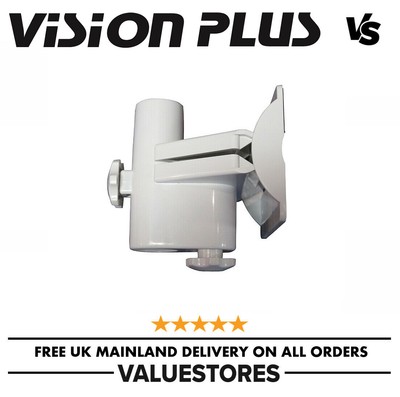

Takes a couple of minutes to mount, aerial lives in the camper chair holder, pole by B&Q https://www.diy.com/departments/tri...-6y2sWwuXI3yHnqs00xoCp5QQAvD_BwE&gclsrc=aw.ds
Awning rail mast clamp
Vision Plus Uni-Bracket & Plate Easily Attach Your Aerial Mast Caravan Motorhome | eBay
The adjustable Uni-Bracket is designed to clamp onto a number of profiles between 1 and 35mm deep such as step ladders, caravan grab handles, air-vents, awning channels or rain gutters. Alternatively there is the self adhesive Uni-Plate which is specially designed to accommodate the Uni-Bracket.www.ebay.co.uk
And a dash cam suction cup for base of pole to give 2 point fixing.

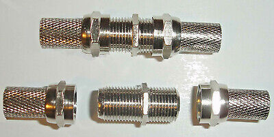

plus various connectors and cable to connect outside van and then give a tv connection inside.
Cable enters van via left hand light cluster cable trunk, behind kitchen unit and out at floor level by B pillar.
Excellent, thank you very much. I may buy all the bits and pieces.
Just an extra use F type connectors for everything except the final one in the van which needs to be F type to coaxial plug.Excellent, thank you very much. I may buy all the bits and pieces.
Sorry to everyone who thinks this post went off piste but see #190 for reason for replyJust an extra use F type connectors for everything except the final one in the van which needs to be F type to coaxial plug.
Reason, the constant making of the connections is useless for coaxial connectors whereas the f types have been in use for 2.5 years with no rebuild.
Splicing Kit fr Extending / Repairing Satellite or Cable TV CT100 RG6 Coax Cable | eBay UK
Coax Cable.www.ebay.co.uk
