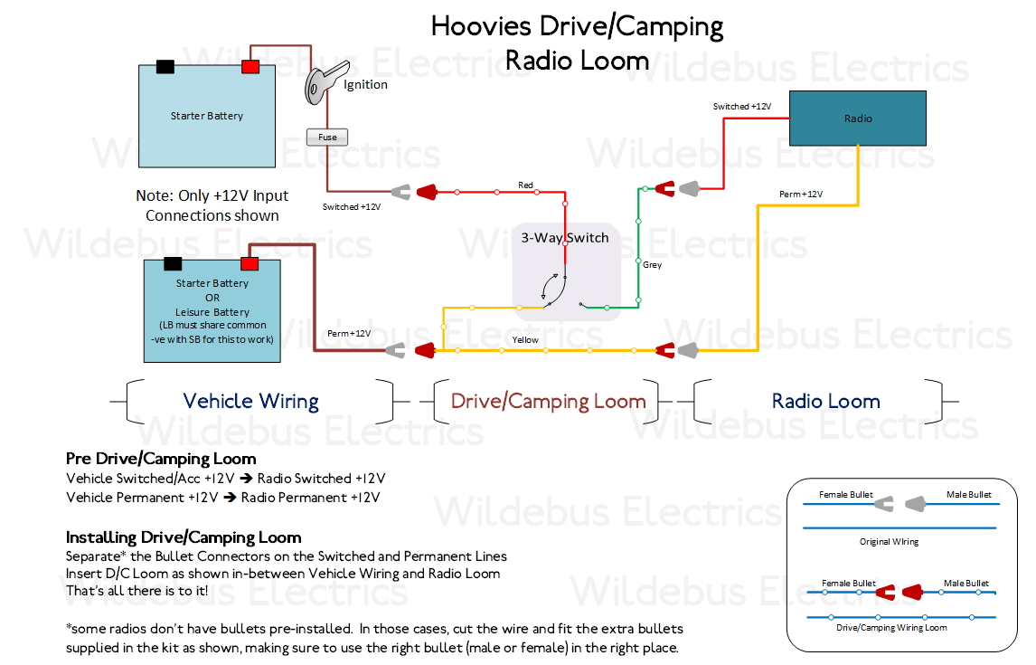

This is what you need, apparently - although I have not fitted myself

Looks like that just connects the power to a live feed. Tha Canbus will still turn it off after twenty minutes.

Looks like it should do the job then. What is the handbrake mute for? I don't think you will find a leisure battery feed in the front anywhere. Could be wrong. I just ran a cable from the underseat battery under the doorstep and up behind the dash.
