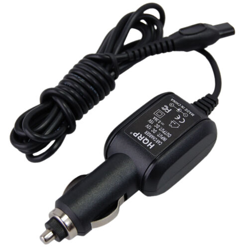

Not sure what shaver you have but looks like there could be 12v charger options. Again keeping you away from the invertor. Check for quality and compatibility but you could investigate something like this as an alternative....but please check before purchasing.....
