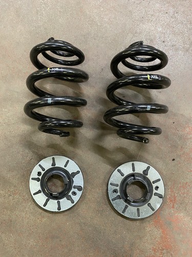

Well, put those T32's on from e Bay. Must say superb service from that guy and at a brilliant price. OK I'm no expert at all BUT, I now have a valid MOT at a fraction of the cost VW wanted and they couldn't supply. But more important for me they seem to be better than the OE springs which had two white marks. The garage reassured me I was safe with a broken spring and said I wouldn't notice the difference with the new one fitted, yet I do. Its quieter. Definitely. Thats day one though. Spain in a few weeks.. Cant wait. £50 springs and £60 fitted..... HAPPY.
If all else fails these are reputedly used on the Cali. At the price might be worth getting as a spare set.
B.J.G. A big thank you. I was in the S**t and looking at £300 parts cost fro VW. Your help saved me over £240 in parts and that supplier was brilliant. MANY MANY thanks.
