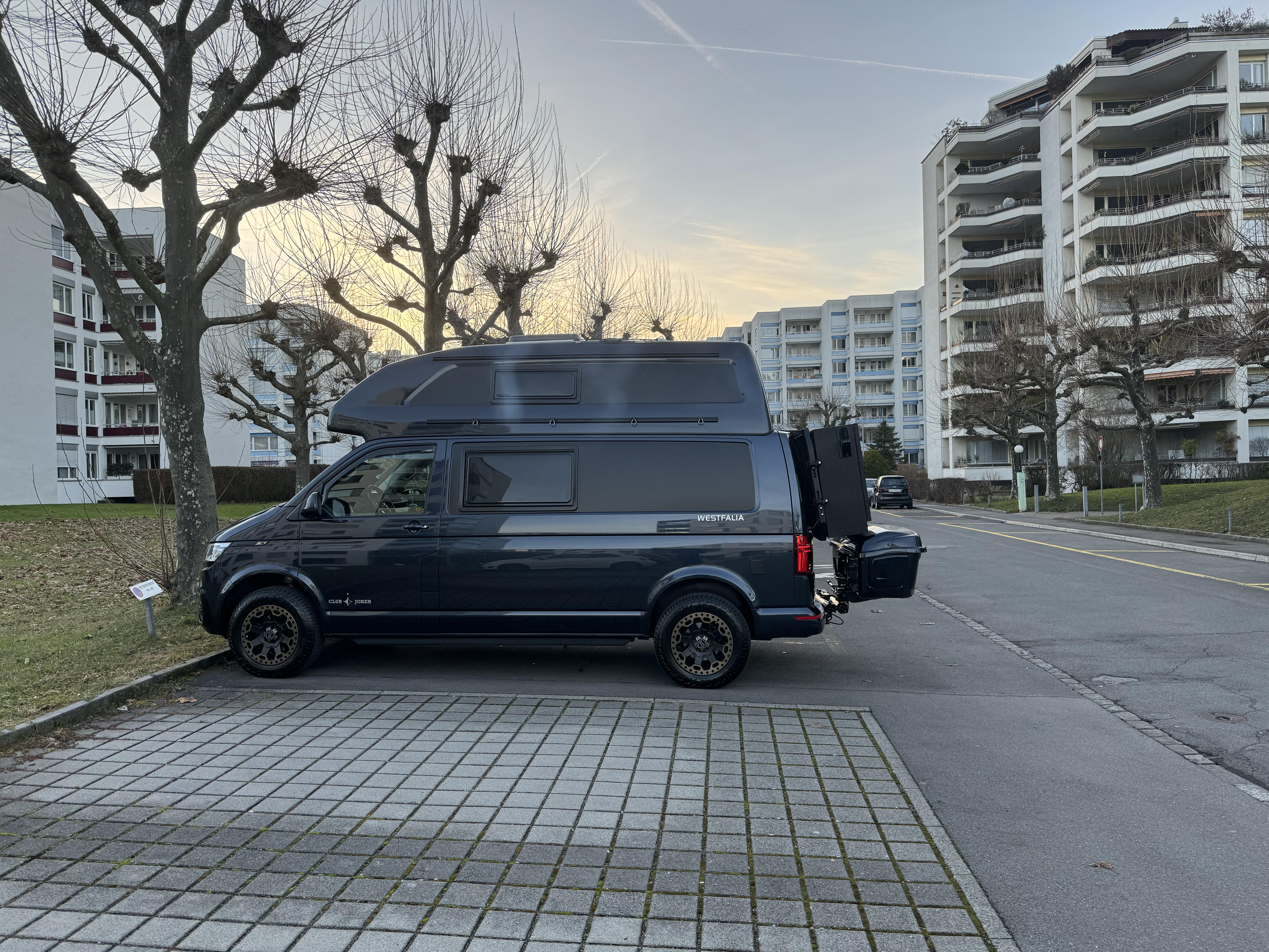

Interesting tow bar hitch design. Whats the purpose for the articulation?
So I can mount my bike rack (Thule Epos) and the handle bars don’t hit the box. Also allows you to swing outwards to open the hatch instead of tilting down.
It’s really handy. I also have a storage box for the hitch and when that’s fully loaded it’s much easier to swing to the side versus tilting down. Never enough storage with 2 young kids!

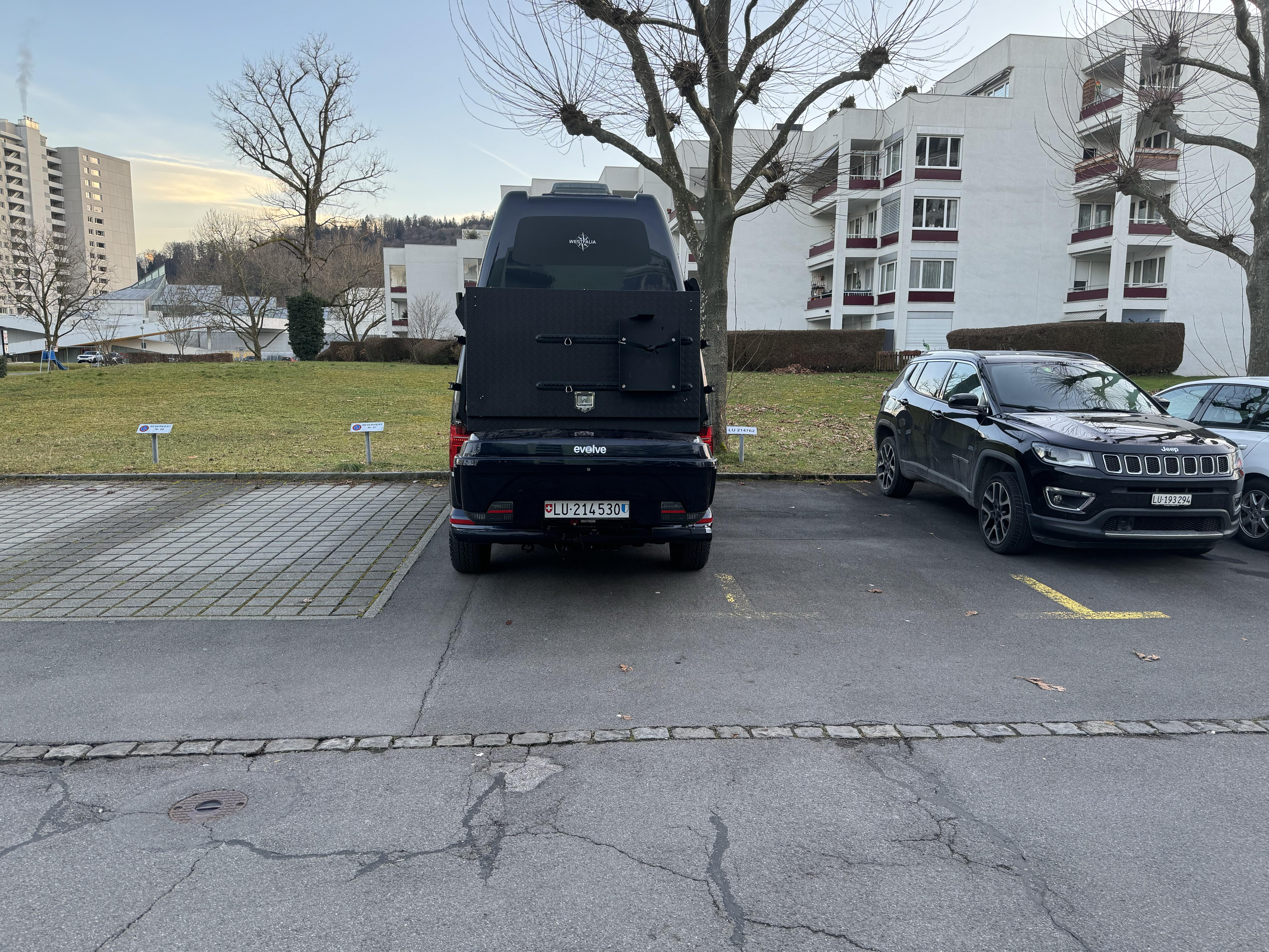

Here you go! Super easy to mount as it mounts on your existing towball. Supports a maximum of 65Kg.
Thanks. That makes so much more sense than anything else for bikes. Time for shopping (again)
Absolutely! When you order you need to decide if you want to swing left or swing right. I have a LHD so I swing right so the bikes are curbside if parked on a street and also near the sliding door. The choice is yours.
Also LHD but I need to think about what works. Assume you leave it on all the time? Does it affect parking sensors?
Yes, the rear camera works fine but you will have a beep in the rear. Doesn’t bother me as I prefer to leave it on ready to go. You really need to torque it down firmly with a wrench on the existing towball.

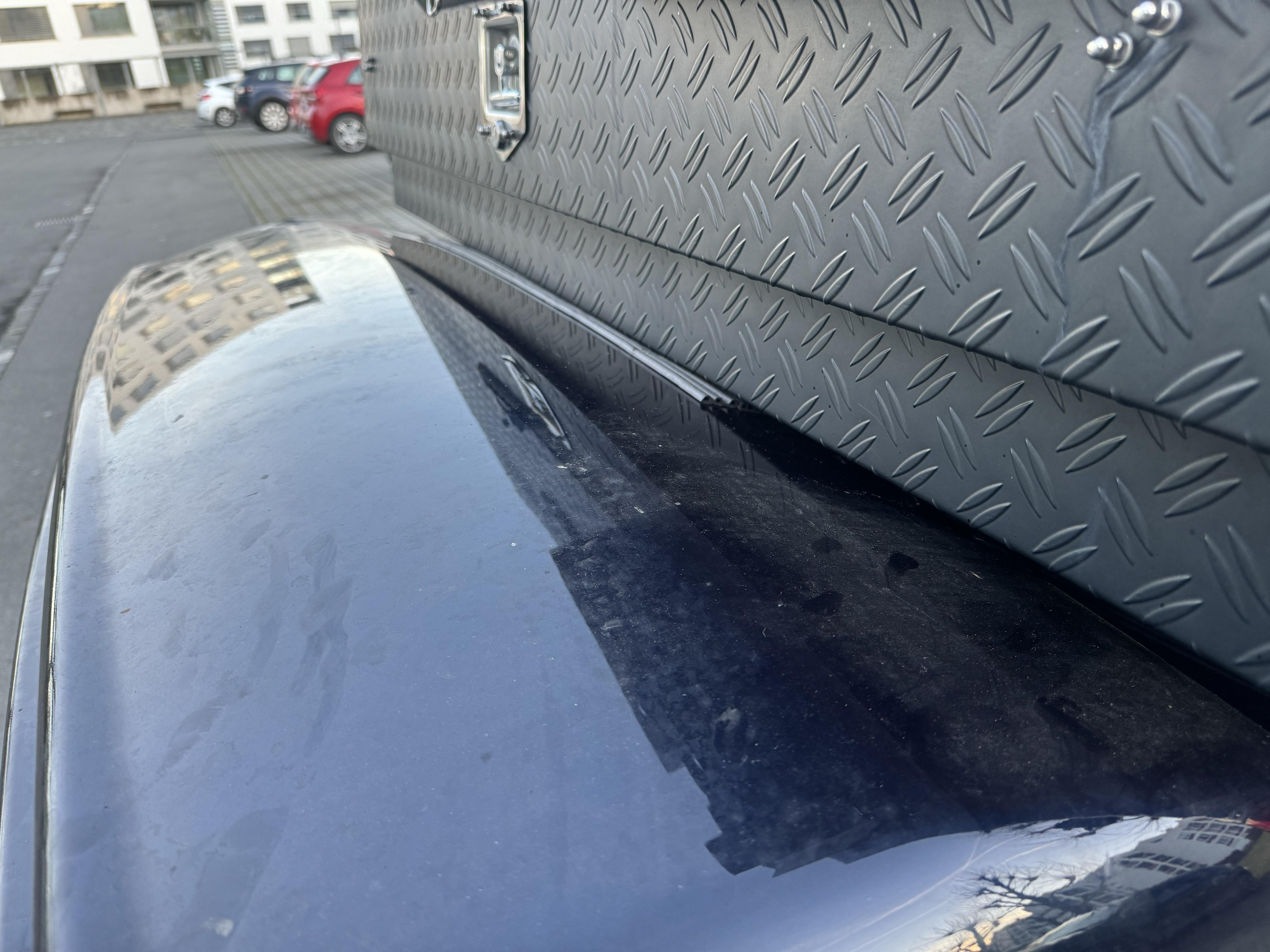

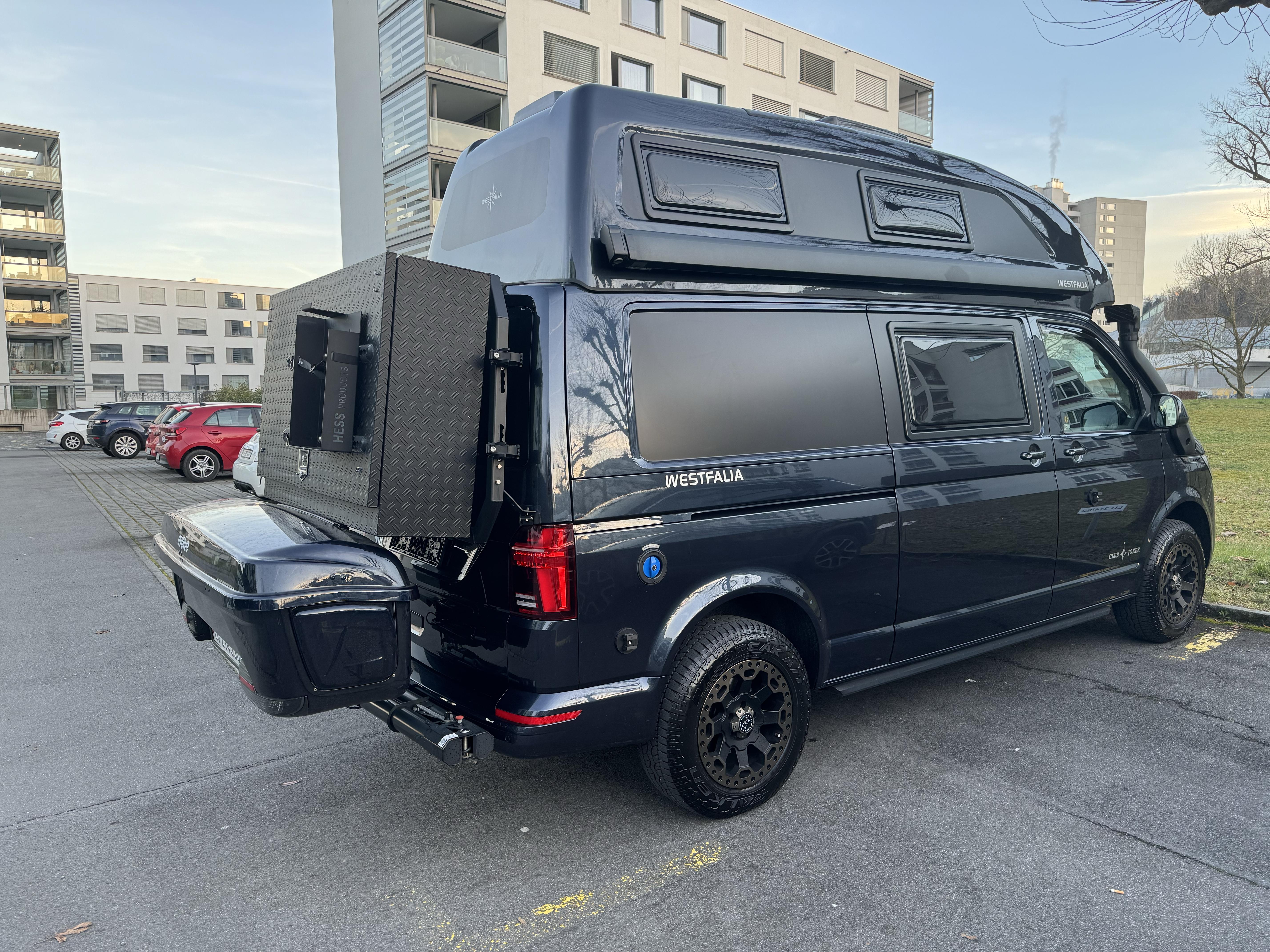

Haven’t used my MFT backbox since I got the Hess Heckbox and the swing away. Managed to fit it but man was that a tight fit! Had to use some rubber seals on the top to prevent scratching but it works!

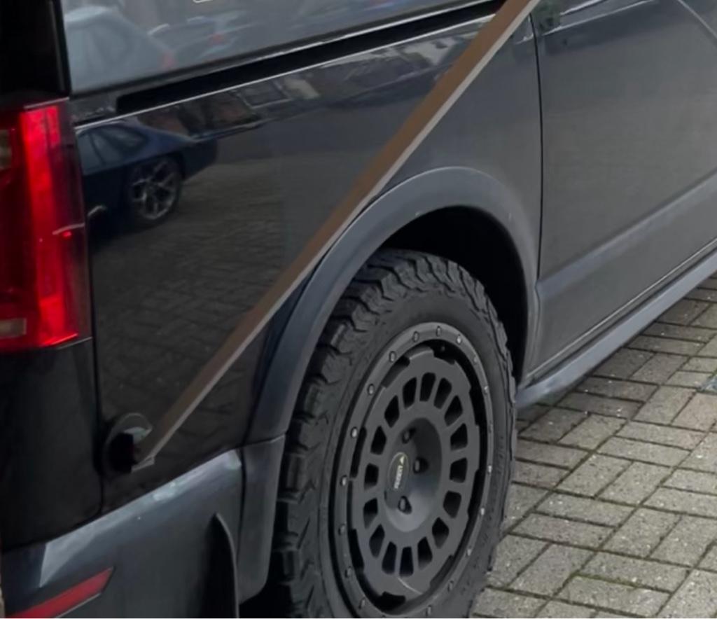

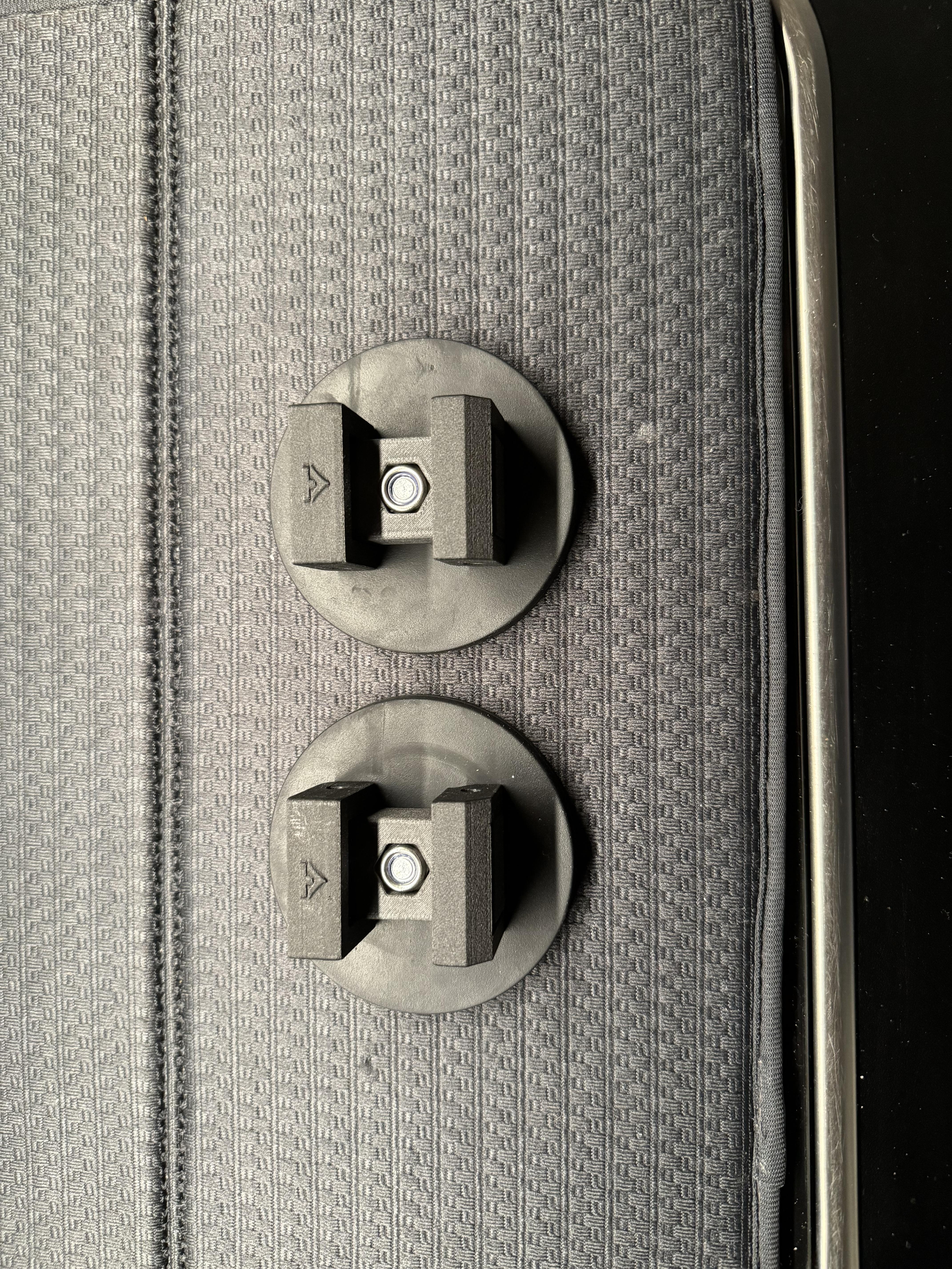

@Webbah_in_Switzerland What are these? Just curious
These are the magnets to attach the Cali awning legs to the side of the van. They work a treat, great for quick pitching the awning on hard ground where you can’t peg out. Also no legs as trip/dog lead hazard. I’ve tested it in 30mph gusts and it was solid with none of creaking you get when legs are pegged.
@wildslammer22 sounds like a good solution. I might be a little wary about stress on the body panels in windy conditions. However, I can see the rear one is at the edge of the body panel, so seems low risk. Is the front one similar?
Just be mindful with the sliding door ;)
Yes, I mount the front one at the bottom of the door panel in front of the door jamb so that’s equally solid as the rear clamp. No panel flex. Just have to make sure the bodywork is clean before you mount them!
Indeed, you have to mount the rear one as per the photo to avoid fouling the sliding door. Although it could be useful for double locking troublesome toddlers in the van…
