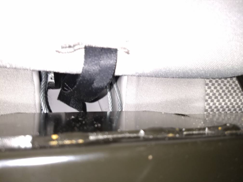

We had this issue on our 2017 Beach. Wife pulled the strap to drop the backrest and the strap came away in her hand. She's not strong enough for brute force to have been the issue!
Anyhow finally got it fixed under warranty but when I picked it up the strap was hanging down behind the backrest, so not accessible from the front. I've posted the strap through and it seems to work but it got me thinking as to whether the strap has been properly fixed (can't believe they gave it back to me like that). Is the strap usually visible from behind the seat?
Sent from my Moto G (5) Plus using Tapatalk
The issue we had with our strap sounds very similar to yours. It ended up being a fault that had arisen from the original fitting of the seat & nothing to do with any of our actions. Once fixed it was very obvious that there had been a problem as it always felt a bit awkward trying to lower the backrest. We had only owned the van for a couple of weeks when it happened. Once fixed we were aware how smooth & easy the operation of the seat back is. If you have any doubts about the functioning of the strap now you have your vehicle back I would query it now. The incorrect fitting of ours caused it to fail unexpectedly. If it fails when the seat is flat, like ours, you can not physically get to the mechanism without taking whole seat out.
Hope it is all OK & fixed for you but if any doubt, I would get it checked now.
