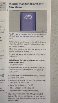

I have a MY 2020 Cali Ocean 6.1 and all I do on a ferry, before locking it, is to press this button on the B pillar driver's side, then press once on the fob to lock it

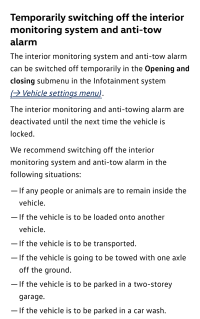

The button still exists. It’s just a software button not a hardware one. This is a lot of chat around something where the answer has always been press the button. Hardware or software.

Here's p75 of my manual that gave me all the confidence I needed

The 6.1 manual no less clear. Just a software button instead. 1746116494238.png

Do you have the switch on the B pillar? If so, press it, close the driver's door and press the lock button on the key fob.
Doors are locked, but the internal movement alarm and tow alarm are deactivated.
