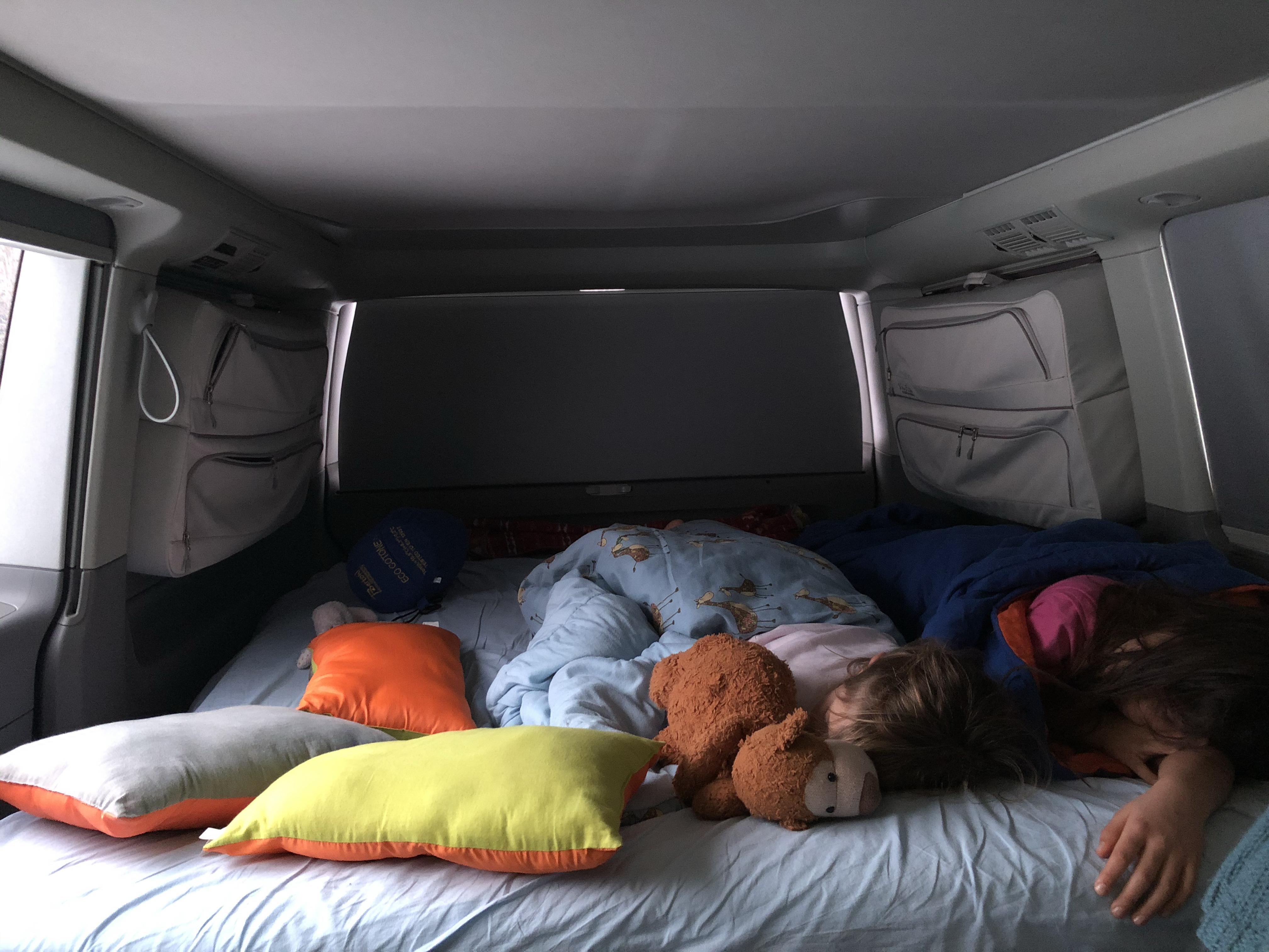

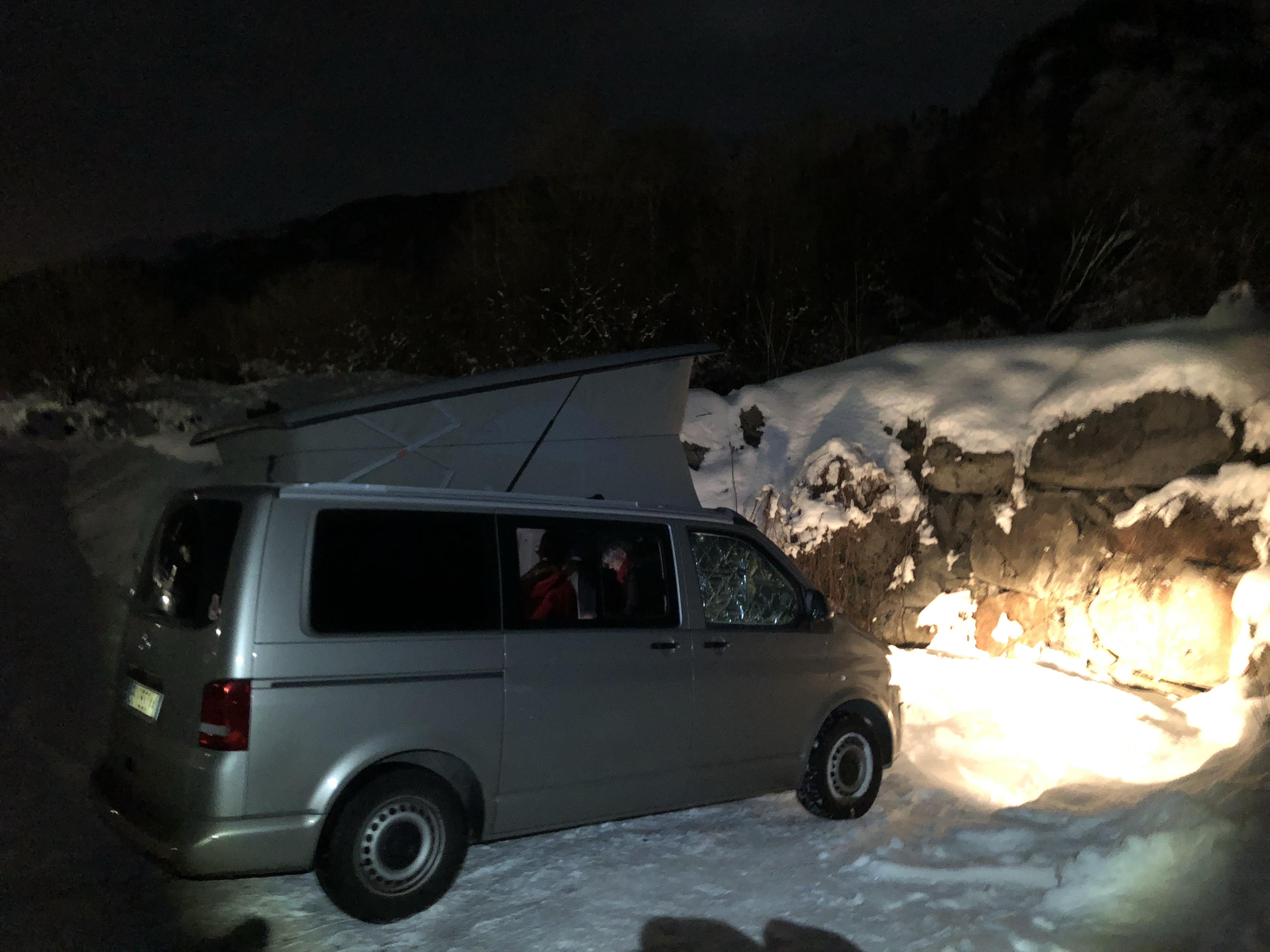

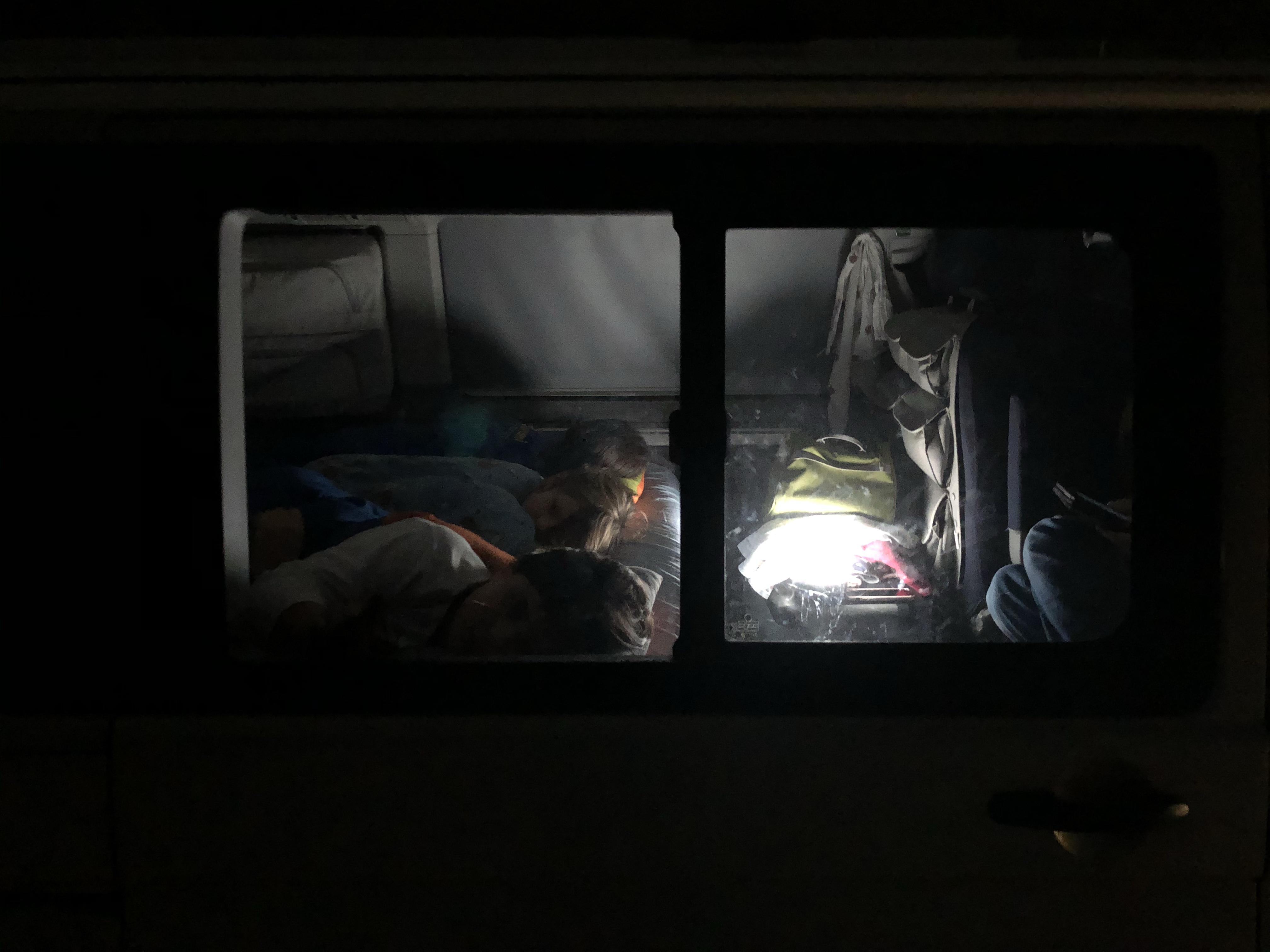

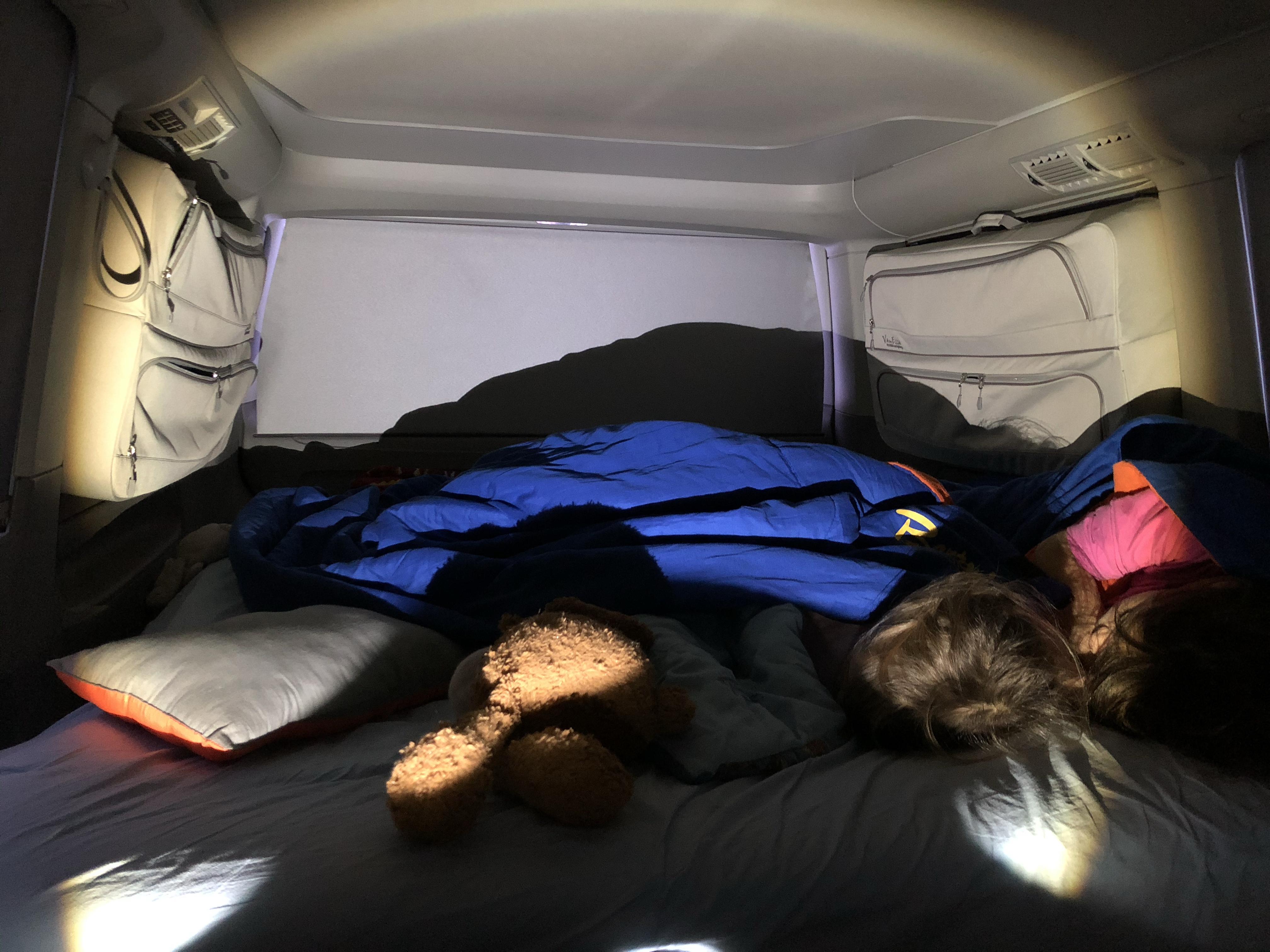

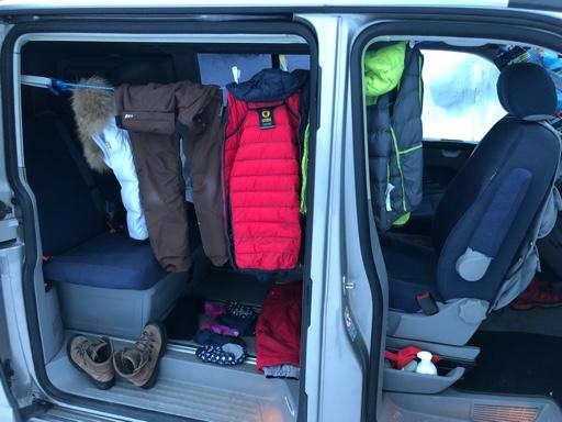

Strange.
Last night in our t5 Beach (2012) sleeping in the mountain (snow at 1000slm) we had perfect warm: downstairs 3 little girls with Heater (eberspacher) set on 2. Upstairs my wife and me with fixed Calicozy and sleeping bag (northface, 20 years old). T-shirts and boxer inside. Super!
Seems I will keep my poor t5 102cv for a long time in the future..
Heater set on 5 is even too much as a dryer (one hour to dry everything inside
