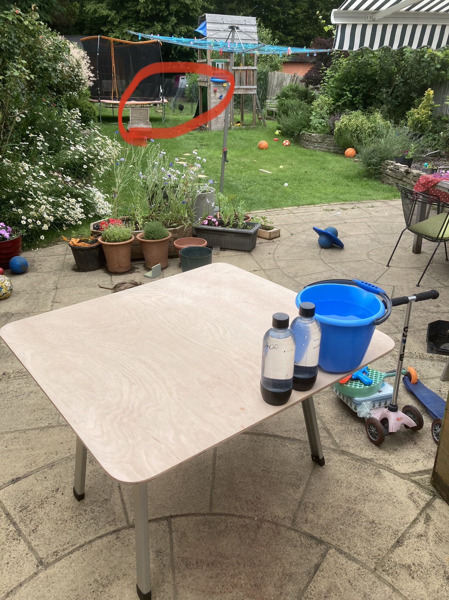

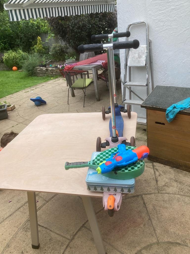

First stability test:-

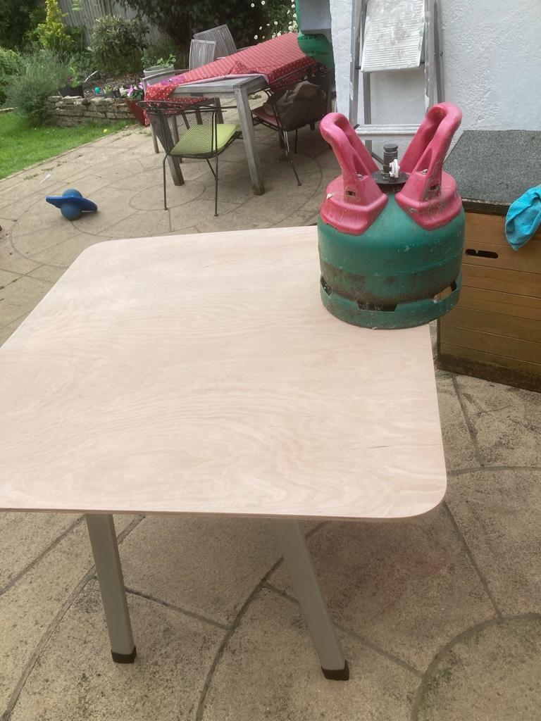

Third stability test

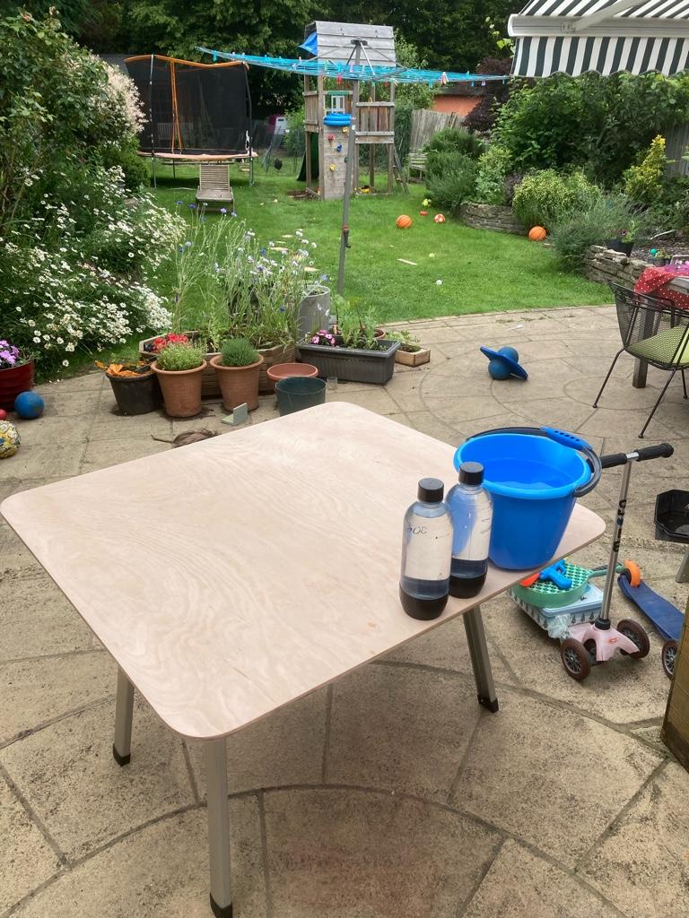

6 litres of water in the bucket plus 2 single litres in the bottles. It will tip with one more bottle.
Static load test. I think it should be Dynamic. Use one of the children and invoke a temper tantrum whilst sat at the table.
