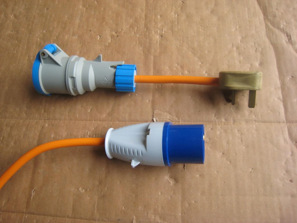

A easy way to plug your Cali into the mains at home to keep the batterys charged up, especially in the winter, is to make one of these.
All you need is a short lenth of cable a mains plug with a 13A fuse and a femail plug to connect your mains hookup lead into.
