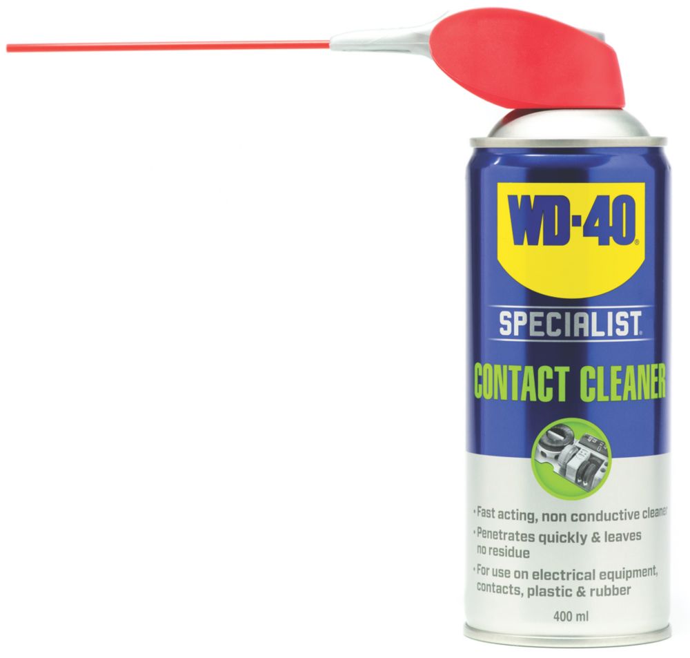

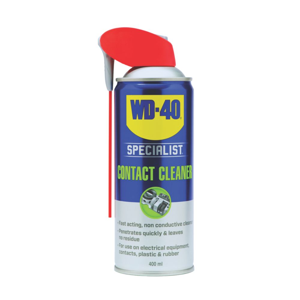

I think I might have this problem right now on my 5.1. I’ve gone round opening and closing all the doors, but we can’t lock from inside in the usual way.
The MFD doesn’t seem to register the passenger door opening. So, what to do in this situation? Will spraying the lock with WD-40 do the trick? Or, is it a trip to the garage?

contact cleaner would be preferable to wd40

I’m back home. The problem continues, but intermittently. It seems ok after a spell on a blowy motorway (the MFD also registers the passenger door opening after being on the motorway).
To my non-mechanical mind this supports the dirty / bad connection explanation.
I’m buying contact cleaner today to squirt around. Before using it, is it worth poking around the door latch with a cotton bud soaked in ethanol? Or, the contact cleaner maybe?
