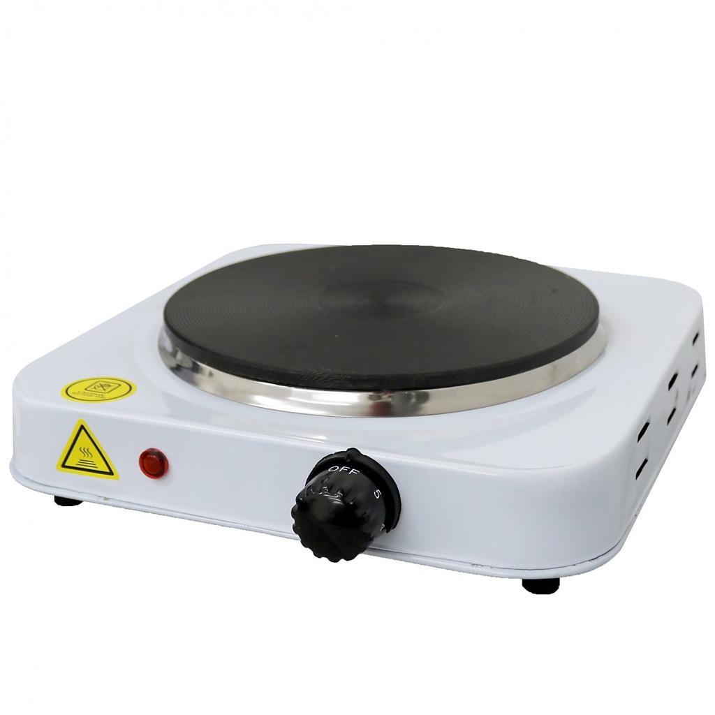

We have something like this:
£15.99 from B&Q
£15.99 from B&Q
That's one of the things I considered but have now bought the small ceramic one from B&Q for £29.99
