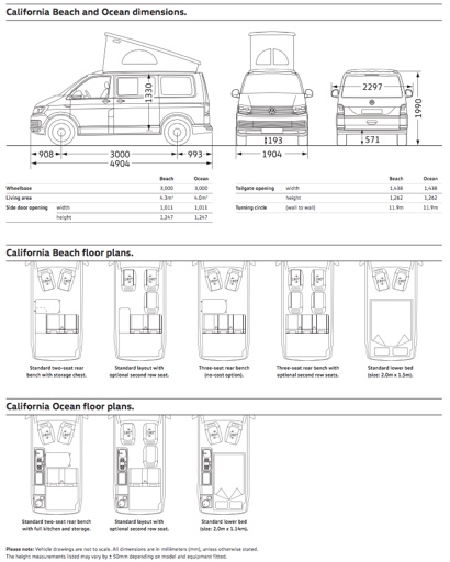

Folding mirrors on the 5.1s and 6s looks very impressive but I doubt it does much to reduce the width of the van.
True but it may save them getting clipped when parked and it's also a good visual indication you've locked the car :)
I feel they my reduce the width more than you might expect.
On hayling Island there is a 2 metre width restriction (unverified). I can squeeze through with my wing mirrors folded but not with them open. If each side saves just 75mm (3 inches) that is a 15cm width reduction, 6.5% of the overall width.
Of course the actual saving needs verification, but I feel you might be surprised. Also note that the wing mirrors are not fixed at the widest point of the van body.
They only fold on the door adjustment/ heater/fold button for me. Reduce the width for sure. I use 6’6” width restricted lanes as folded up we are within that width, mirrors out then a bit over. Yet to be challenged on this though..

A quick measure and I reckon it’s about 100mm reduction per side when folded..... now all I need do is remember to fold them!
