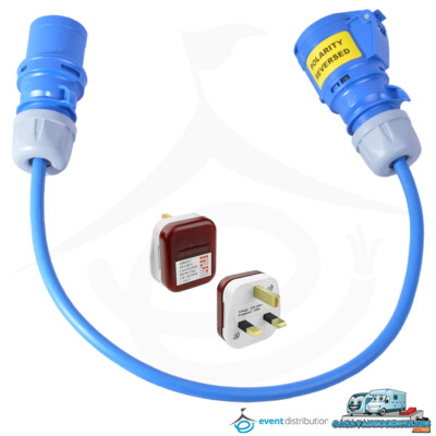

How do you sort out the polarity issue please?

Use a Test Plug in the Mains socket on the Kitchen. If you have Reversed Polarity then you can either change the wiring around on your Blue Plug on your lead or fit a Reversed Polarity Extension.
You can make or purchase a short adaptor lead with the live and neutral crossed.

Reverse polarity means that the neutral line would be switched on/off leaving live line continuously on.
The simple 'Tourist' French plug to UK 3 pin type adaptor commonly available reverses the polarity so beware if using one.

It matters if you are connecting any electrical appliance as if it has an on/off switch then that only breaks one wire line. Reverse polarity has the live supply coming in through the neutral wire into the appliance and out through the Live line. The switch is in the Neutral line in a reverse polarity scenario and when that is switched off Live power is inside the appliance still up to the switch. ie the switch stops live getting out instead of into the appliance.
This isn't a problem if appliances are unplugged when not in use.

I am thinking then that if the polarity is reversed, I remove plug, rotate though 180 degrees and plug back in - is that problem solved?
