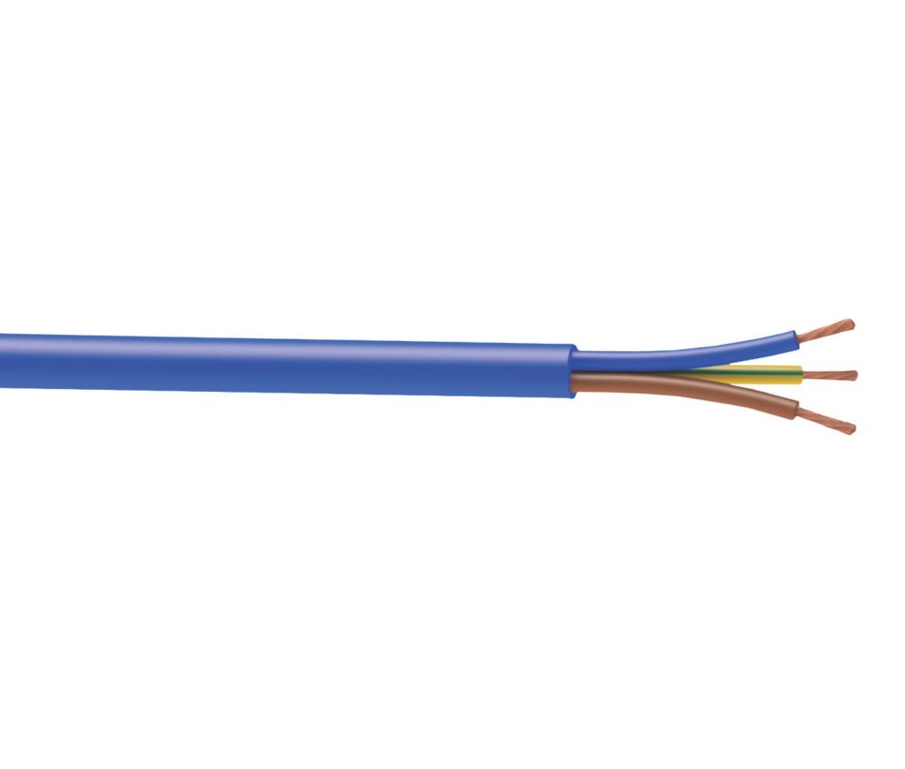

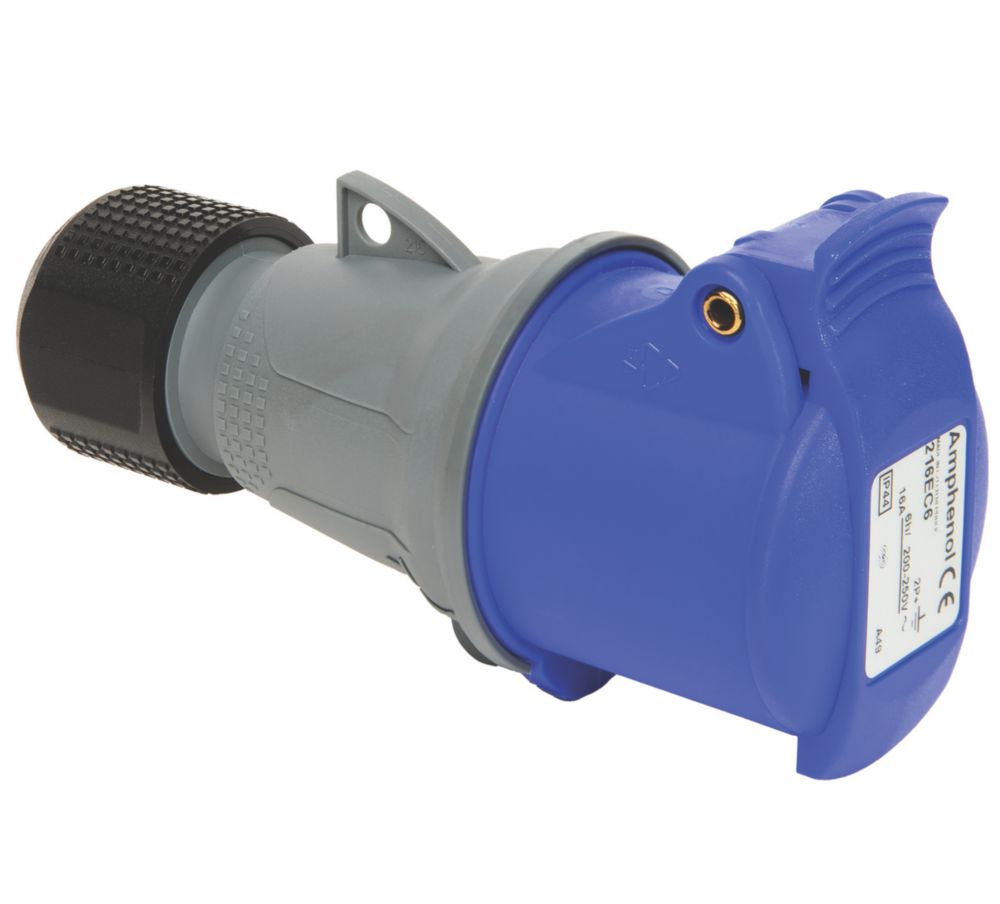

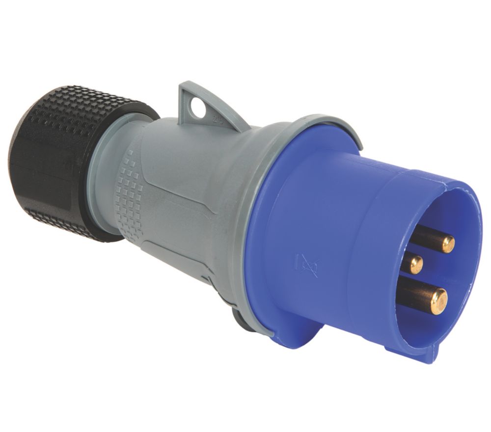

Is there anywhere that sells a 50m 1.5 cable with the male and female hook up connectors in each end?
I made my 25m using parts from Screwfix using cold weather cable, (50m drum), I used 1.5mm2
but 2.5mm2 is also available. So if you use whole real, you could do 50m (although a handful)

Thanks, is it easy enough to wire up the connectors yourself?
