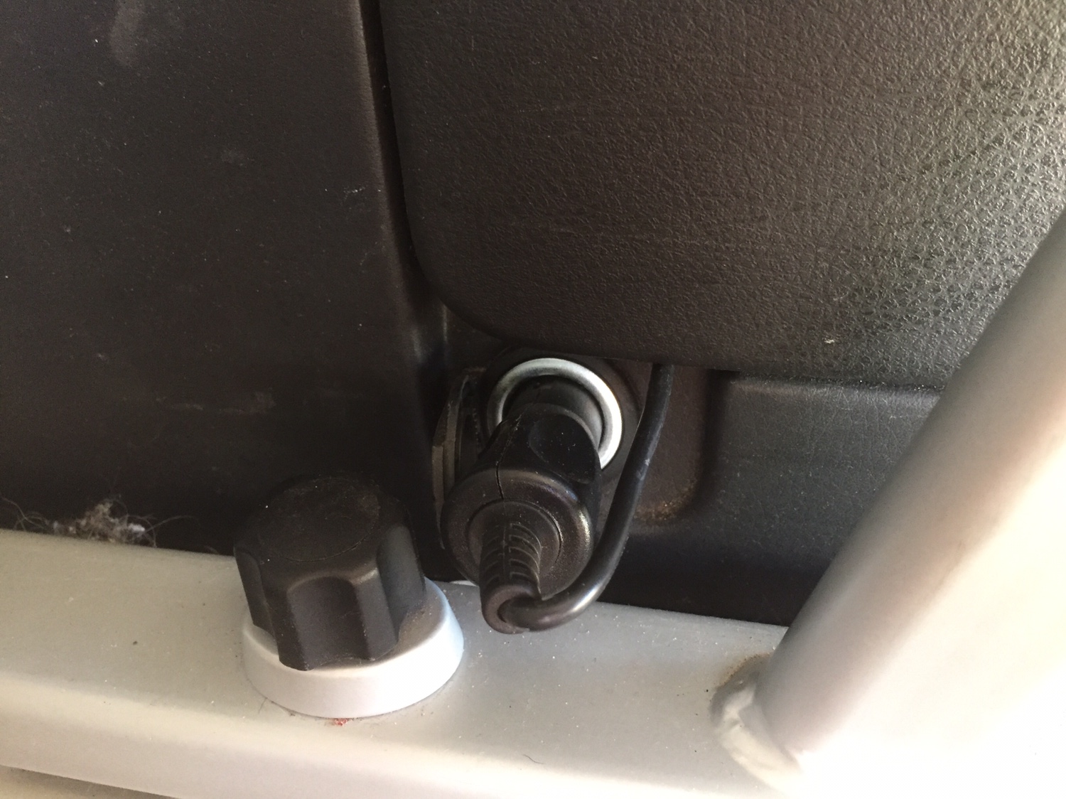

Fed up with plugging in an unplugging 12 volt sockets for external awning lighting, I have now rigged up a medium term solution.
Using the rear socket, with the multi-flex slightly forward of its rearmost position, I run the cable under the trim.

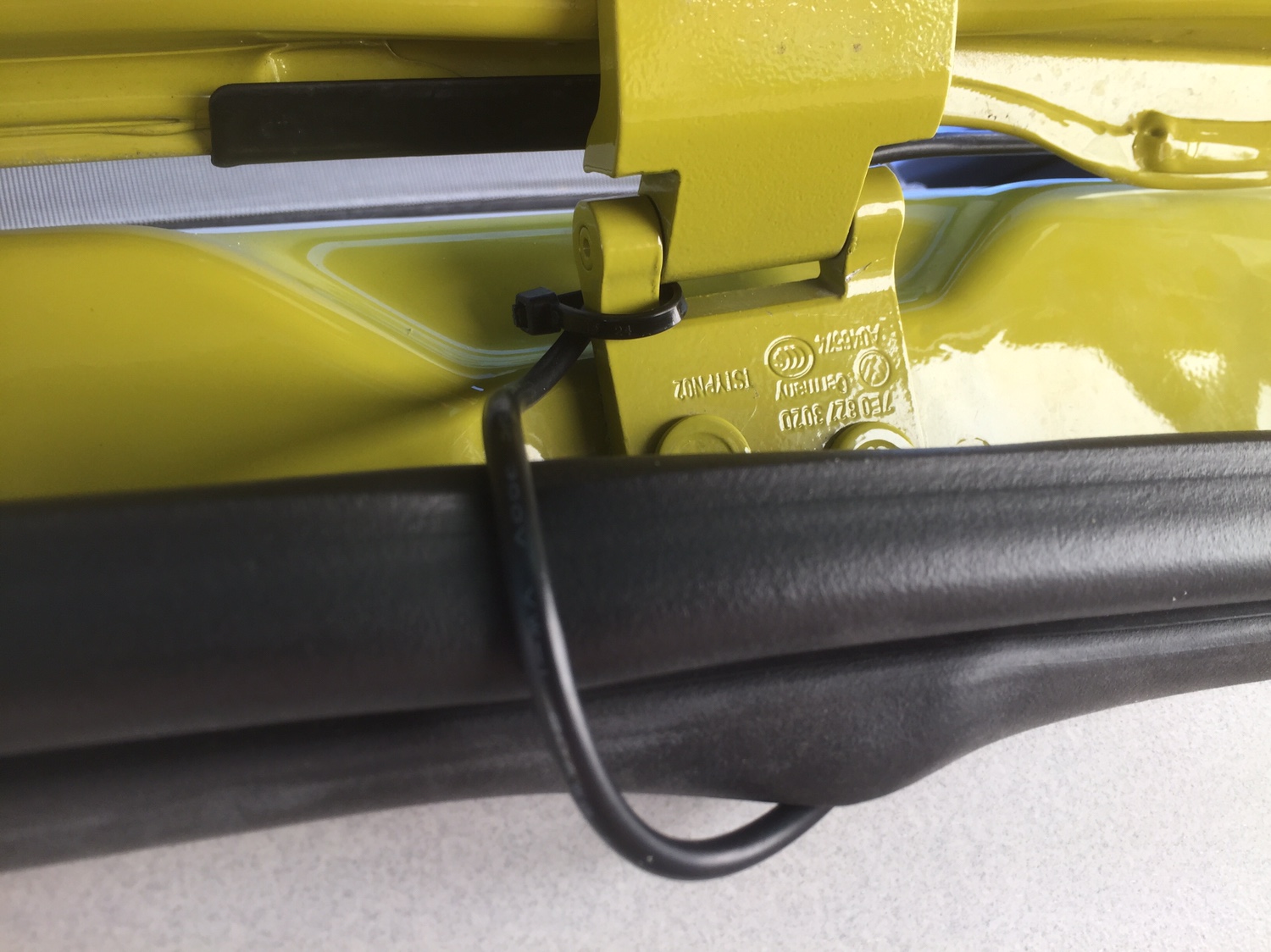

It emerges from the trim at the left tailgate hinge and is cable tied to the hinge.

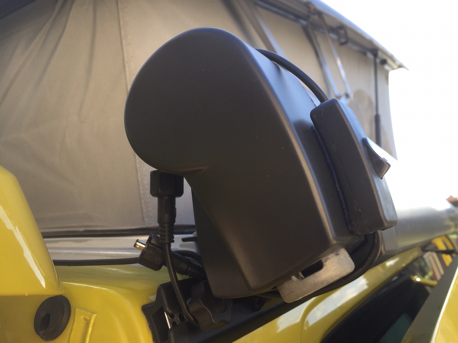

The cable is connected to a switch which is secured to the awning end cap with Velcro, ready for LED lights to be connected to light the wind out awning and driveaway awning when camping.
I have found pitching in the dark difficult. Now all I need do is wind out the awning, attach a light strip to Velcro already in place, connect the light to the switch, turn on the switch and I have light to pitch the driveaway awning.
The Vango lighting system will take up to four LED strips, ample lighting for the wind out and driveaway awning or even an outside eating area during dark and balmy autumn or spring evenings.

Just be aware Tom it looks like the switch does not have the correct IP rating for external use so keep it dry. Would it fit inside the awning at all?
There is space at the front of the awning case for mounting, but not at the rear. It is only secured with Velcro, so it's easy enough to take off, and I have end caps for the cable.
Be aware that in heavy rain, especially when driving, you may get water ingress where your cable comes over the Rear Tailgate rubber seal.
Originally Roger Donahugh had the Solar Panel input lead over the seal and I had water ingress at that point so reworded with the Solar lead going through the Tailgate wiring loom corrugated rubber cover.

This might be a better solution/plug for the Rear 12v Socket. Less likely to get damaged.
http://www.ebay.co.uk/itm/12-24V-Ri...angled-Plug-LED-Fuse-cable-17cm-/122458450662
Thanks.
I'm probably stuck with what we have until we return to the UK. I tried to get some stuff delivered to us in Sicily, but some went astray requiring a credit card recharge, so I'm reluctant to try again. So unless I find a Bulgarian Maplin, we will have to make do.
At least the plug is protected by the multiflex frame - the multiflex stays in the same position for the bed and when the van is loaded.
I'll keep an eye on water ingress. If it is intolerable I have a spare connection lead and may try to feed that through the tailgate loom as I have with the panels' wiring.
