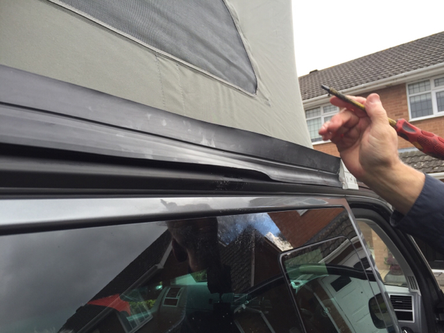

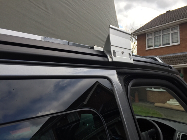

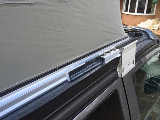

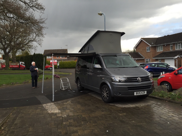

So we fitted the awning today. Relatively straight forward.
At first glance the instructions seem a little insufficient but in reality they are fine and worked well.

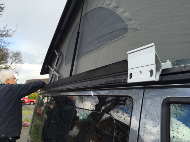

2 man job for sure,or rather two man to lift it on. The prep could have been done solo.
My recommendation is to fit one bracket at the front and then fit the rain seal before permanently fitting the rear bracket.
The seal is probably the hardest part of the install. I found washing up liquid helped a little but the best bet was to insert from the front, bend it towards yourself and push the Seal in hard with a thumb. Ouch painful.

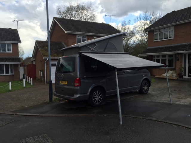

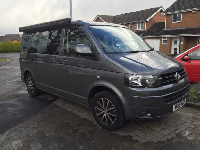

Really happy with it, looks smart in black as does the gray canvas. The mechanism is great and easy to use and gives good coverage.
Very happy indeed! Thanks Nick!
bending the seal back and pushing in hard with a thumb seemed the fastest method. This allows you to see if it was inserted properly as you went.
Very slight height increase but I haven't measured exactly how much. I will do so tomorrow.

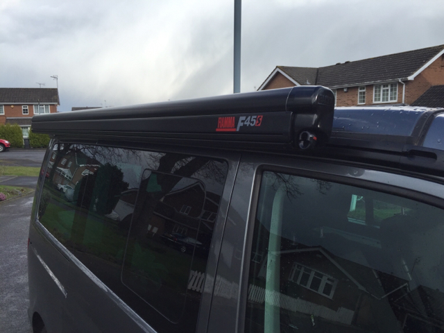

Mattbw,
Can you buy the sealing strip (2nd picture down) as a separate item, as when ours was fitted their wasn't such an item.
John
It came in its own box separately so I believe it's orderable on its own.
Nick at @comfortz may be able to order one for you.
It stops the water coming between the van and the awning.

from experience I'd recommend both the Fiamma Rafter (keeps it taught) and either their tie-down straps / guy ropes or their heavy duty tent pegs. both available in yellow to match your mirror caps!
the Fiamma literature warns that it's a sun shade only & should be rolled back in during rain and/or windy conditions, but I'd keep it secured full time now - an unexpected gust of wind on an otherwise dead calm day in the Highlands last August lifted my F45S straight vertical and slammed it into the raised pop-top. didn't do the aluminium mounting brackets much good ...
