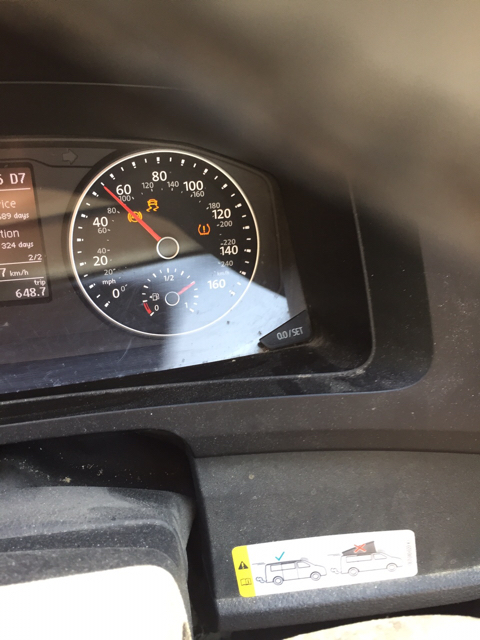

Driving at 62mph on the A3 approaching the A3(M) near Portsmouth, driving on adaptive cruise control, without obvious cause, three warning lights came on and a “no front assist” alert flashed up. The warning lights remained illuminated and I lost adaptive cruise control.
As we were close to our destination I continued at a reduced speed.
After ignition off then on the only warning light on is ABS.
I guess this is a visit to the nearest van centre for a reset, or should I call out VW assist?
I would give vw assist a call but look at your front sensor and check if it’s been damaged or hit by something also check it for security as I’ve seen the support bracket crack and cause the sensor to be loose causing an incorrect alignment angle

What seems odd is that the ABS fault light isn’t resetting while the other fault lights have after ignition off.
I had that combination of lights, and lost acc. It was caused by the gear shift throwing a glitch.
Cleared it with carista, never came back.
Everything has cleared this morning, the abs after a drive around the block. I checked the tyres as a precaution and all was good or at least +/- 0.5 psi.
