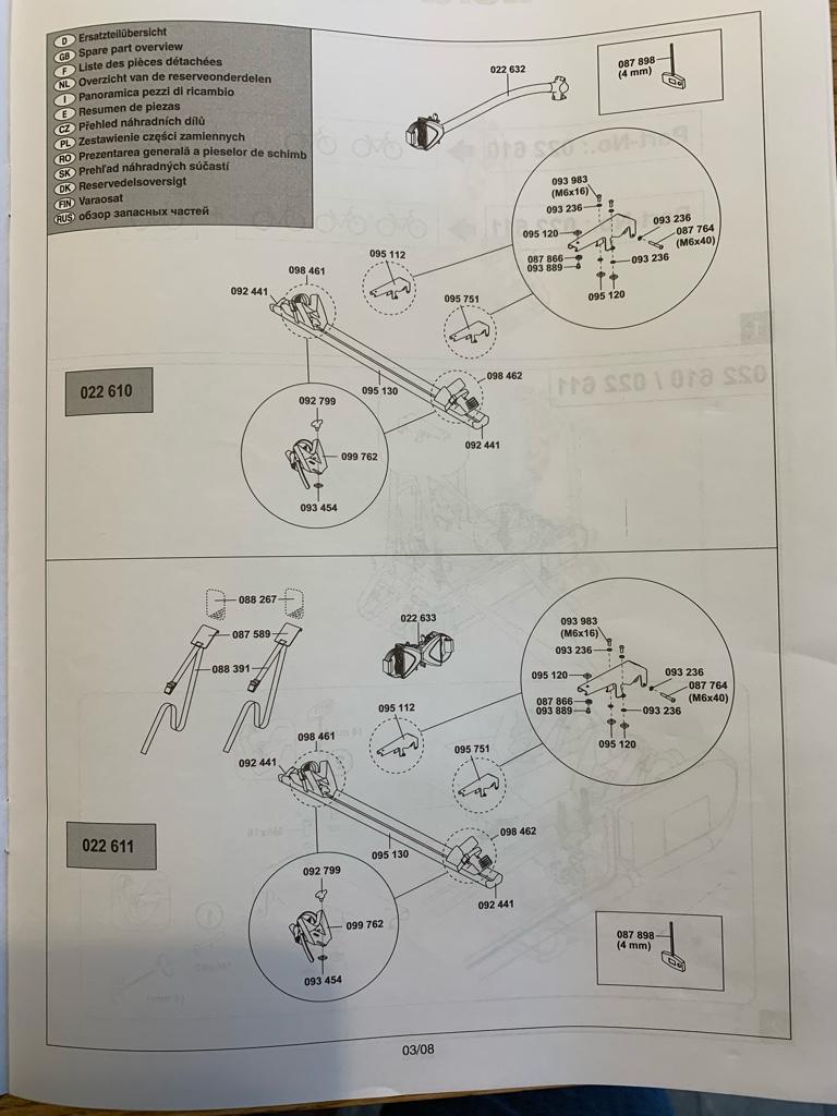

Neilos, are you able to post a pic or a model/item number for the strap you mention please? Been looking for one but not been able to find anywhere in altera spare parts catalog.
I've just checked on roofbox website about these straps, I bought secondhand so didn't get any, they aren't strictly needed. I've had 4 bikes and not felt it needed anything extra.
Here you go, on the top LHS of the bottom pane
Do you use the straps attached to a bike or the carrier?
Is the part ending 267 stickers to prevent your paint work getting damaged?
Thank you. Exactly the information I was looking for. With 2 electric bikes, I think my Thule will be near the max load limit and having the additional straps just gives you the peace of mind.
>>> either is fine. The carrier is preferred/recommended.
>>> correct.
