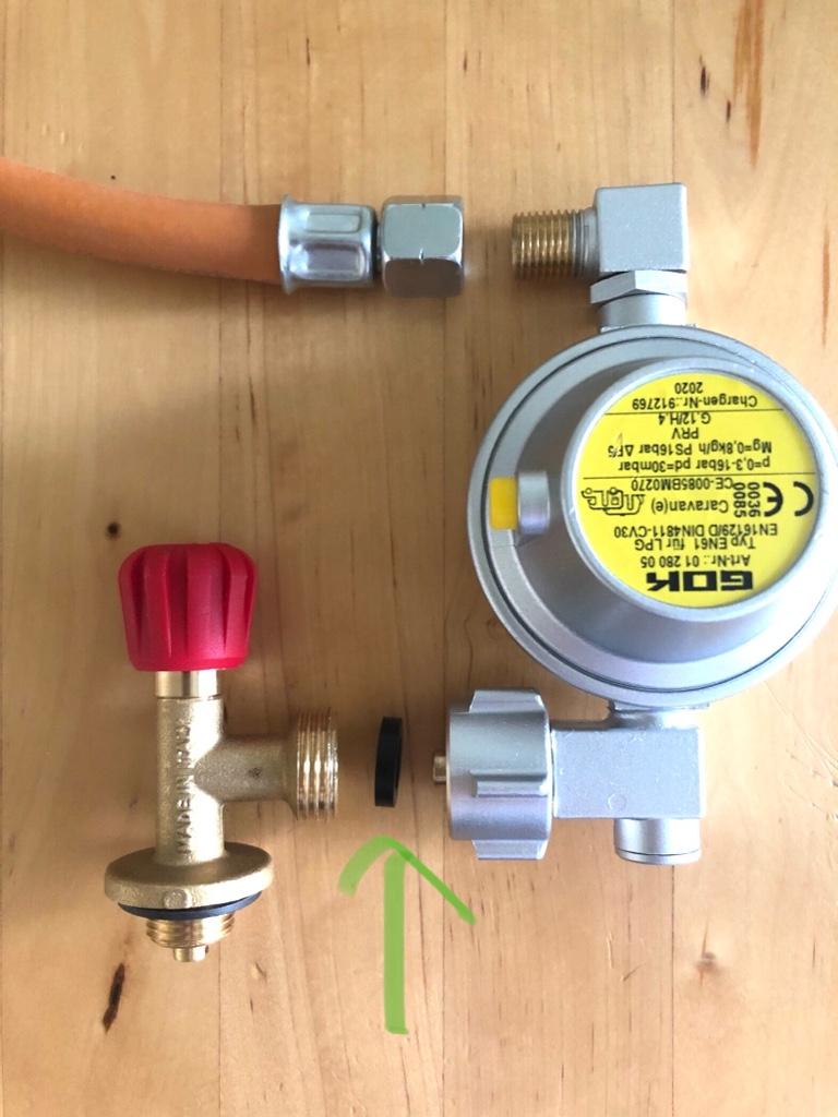

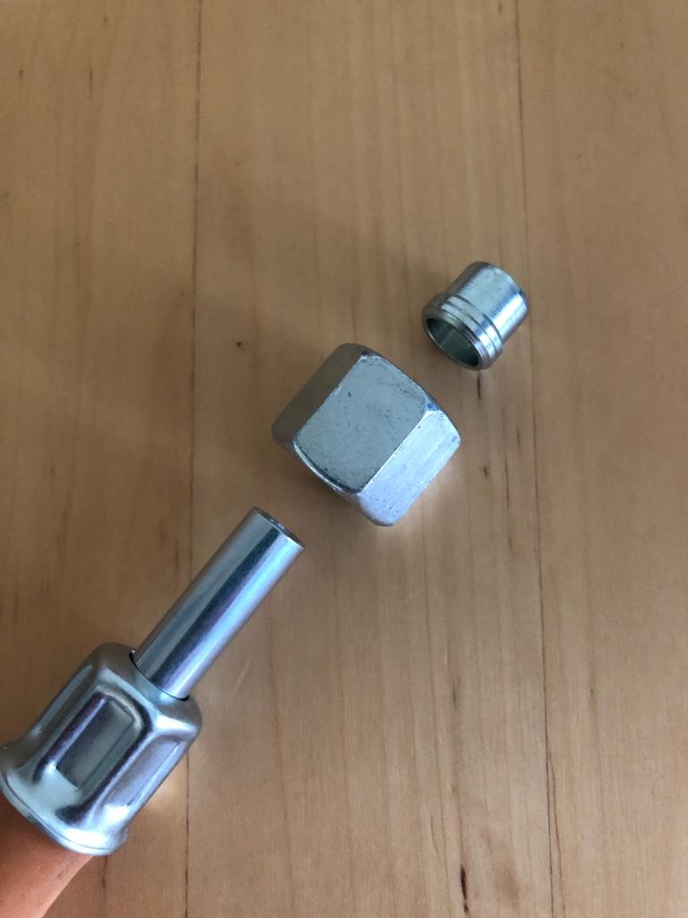

Got the new parts. Could someone just verify that this is the correct assembly? Gok instructions are not clear.
1. Small rubber seal should be placed between valve and regulator as shown?
2. Olive nut goes into nut as shown?
