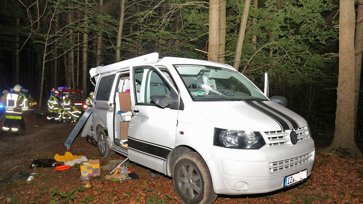

Not to scare you - this story and images are from a converted Transporter and no safety measures.
