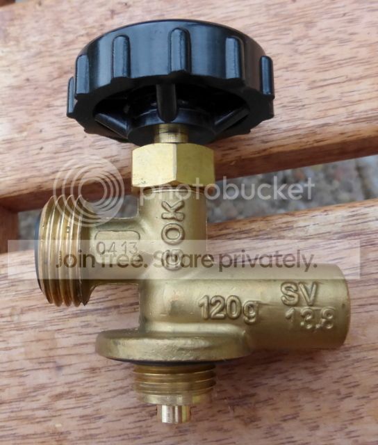

I will soon be changing the Camping Gaz cylinder & thought it would be a good idea to change the 2 seals on the gas tap at the same time (doesn't need to be at the same time, of course).
But I have not found the right seals anywhere.

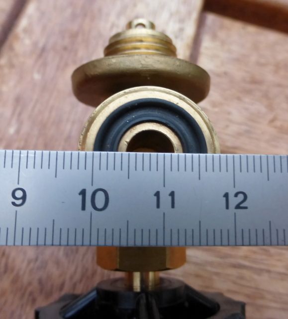

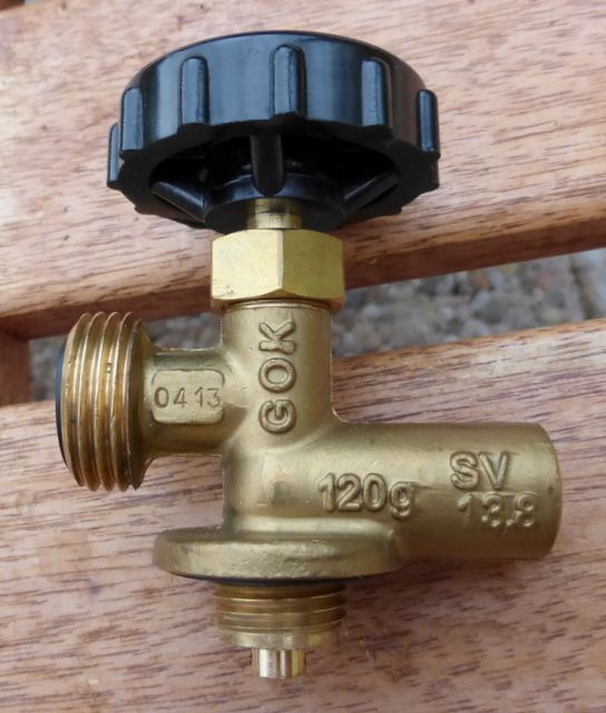

This is my tap & seals (I suppose everybody had the same originally?):

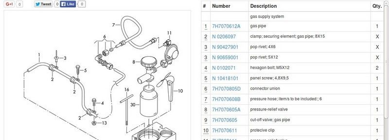

The VW parts list shows the tap but not the seals:
I found the tap on the original supplier's site:
http://www.gok-online.de/de/produkt.../camping-leitungssystem/gasflaschenventil.php
There seem to be 2 models & I think mine is the KLF (G12?) but not sure.
They give a part number (10 017 22) for the seal to the regulator but no dimensions.

I contacted Socal.co.uk (who sell the GOK tap) & they very quickly replied (thanks!):
The inlet fitting is Euro G3 (Camping Gaz refillable cylinders)
The outlet fitting is Euro G12 (KLF)

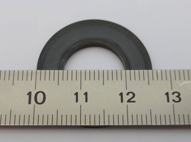

I got a reply from GOK:
The cylinder valve for the Campingaz butane cylinder, GOK part no. 09 736 00 has two seals:
1. at the connector for the Campingaz cylinder seal 26 x 14 x 1.5 made of NBR, GOK part no. 20 015 29
2. at the connector for the pressure regulator seal 16.5 x 10 x 3.5 made of NBR, GOK part no. 10 071 22
We recommend to contact camping shops or gas shops in which you could also buy Campingaz butane cylinders.
Should you require any further information, please do not hesitate to contact us.
So I will keep looking - at least I know the dimensions now.

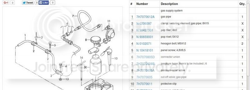

@2CV67 may I ask where you found that part list? The image with the list of all the parts for the gas system that is. Thanks!
