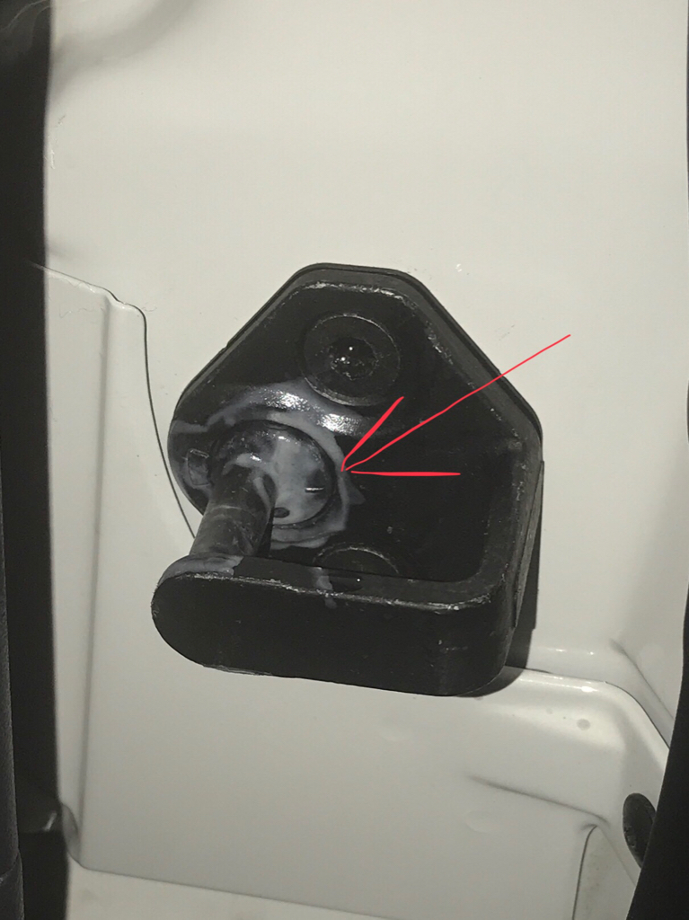

Thanks again Mike - I bought some spray on grease (not WD40 which I used randomly last time).
The pin highlighted in the pic rotates to pull the door in. I bridged the contacts and watched it rotate and it only made the grinding noise when it wasn’t under the tension of the door being coupled to the latch so -
As you suggested, I squirted some grease around the base of the rotating pin (where it disappears into the door/motor). Silence for now at least. Thanks!

Try cleaning, lightly lubricate the soft close locking mechanism on the C pillar, it rotates to pull the rear of the sliding door in. Does the reverse when you pull the handle to open the door. Could be the cause?

yep. just done that and it worked a treat.bit of duck oil on the cam.didn't even know that was how the soft close worked. i do now. cheers. i love an easy fix

Yes, that's the part. It will make a noise on closing. Seems loud on a quiet campsite in the dead of night.. That's normal but shouldn't grate or grind unless dirty.

yes. the pic with the red arrow on it. i used duck oil with a straw to get right in at it. it was definitely a grinding / ratchety noise mine was making. the normal noise is more of a whirring. you will instantly know if the noise isn't right. oddly mine only made the nasty noise on opening and closing was the normal whirring noise. it was definitely the cam shown as the noise has instantly gone
Mine is still good. I did apply the grease very liberally through a straw aerosol right on the join of the rotating cam. You definitely know when the noise isn’t right.
The correct noise sounds a bit like a CD being inserted into a head unit but louder and quicker. The wrong noise sounds like teeth being stripped off a cog.
If it makes you pull a face like a bulldog chewing a wasp - it’s the wrong sound.
