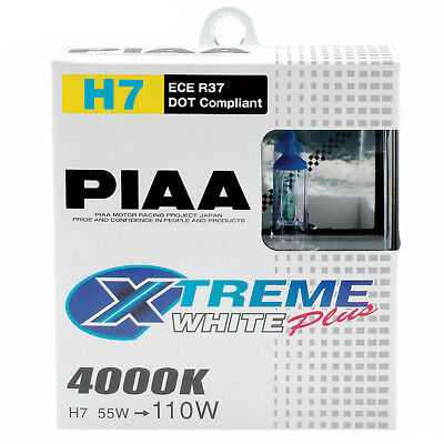

I'm debating trying the expensive PIAA 4000K extreme bulbs, more than twice the price of the others.
PIAA are in the Cibie category for competition use lights.
Since read a USA report on these and they didn't see the cost justification over other upgrades.
interestingly I found that they referred to the fact that Halogen bulbs degrade over time and that they should be replaced every 2 years. from that I'd say if your bulbs are 4 or more years old then an upgrade replacement would be a good idea as standard practice.
