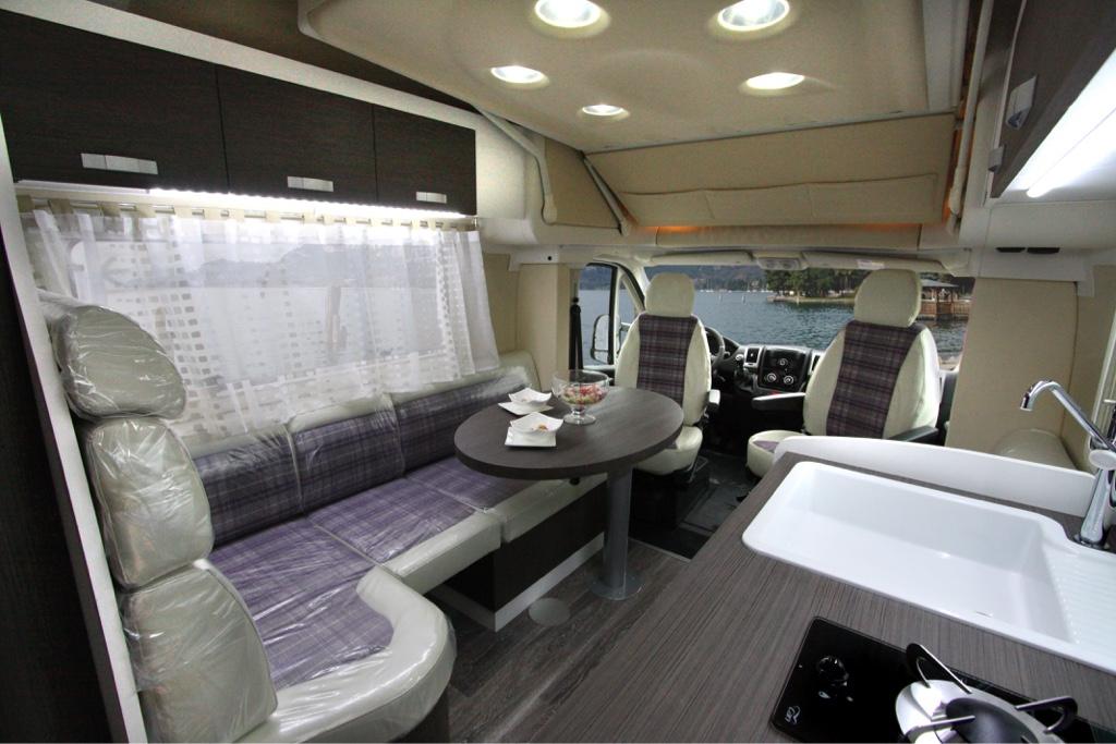

Love the wingamm bed very clever, only down side is the head room when shut isn’t great if you’ve over 6ft.Agree - A simple single hinge point bed as per a Cali in a high top roof does not work as you lose your standing height rapidly.
However, if you incorporate a second hinge point designed to match the curve of a high line roof (and if your front hinge incorporates a sliding action), then you end up with a drop down bed that will closely follow the roof profile, giving you maximum height in the living area within a short van (see pic)
The sliding roof bed options generally used in high tops work well (for example in the Joker) and many with high tops simply sleep downstairs but want the extra height of a high top for permanent standing room, better insulation and increased storage capacity.
