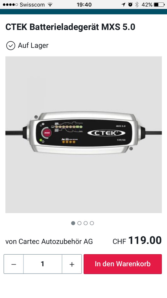

Hello CLaw
I use the "normal" hook up for the 2 camping batteries and a CTEK MXS 5 for the engine batterie:
Post 2010 Californias are able to charge the Leisure Batteries and trickle charge the Engine Battery.
Hence no need of a 2nd charger.
Thank you WelshGas.
I think that was the reason why I bought/had to buy the CTEK thing.
