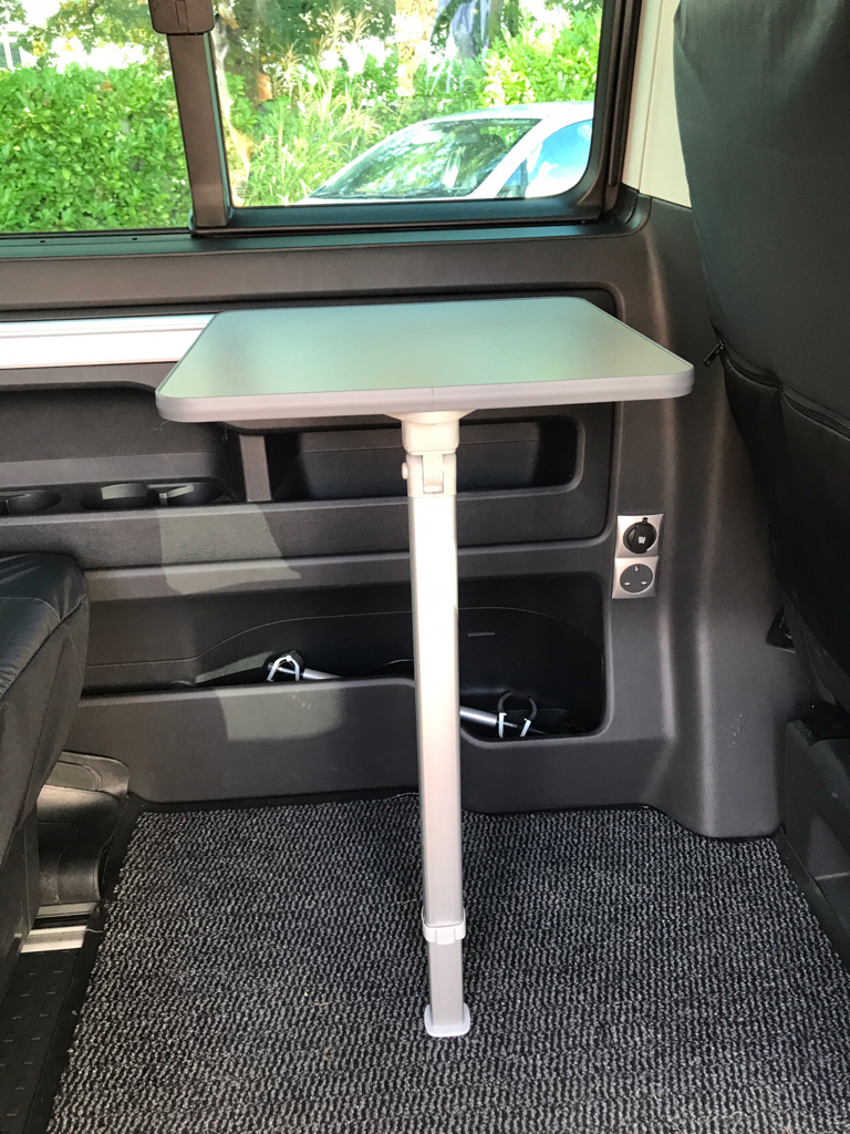

I built my table a few weeks back and can’t believe how useful it’s been. Cuppa/wine glass holder when downstairs is in lounge mode, keys/phone/wallet dumping spot when using the downstairs bed and the perfect laptop desk when doing a bit of work. It takes up hardly any space, allowing the rest of the family to move around the Cali, unlike when you have the regular Cali table up. Not sure how we managed without it!
A big thank you to those who contributed to this thread!
I think ours is same as the pics on this thread about width of the tape measure.
We held everything in position with tape first before committing to drilling just to check.

My wife started this thread, for info I used a 6mm sheet of aluminium (might be 1/4 inch would need to measure it to be exact) , no clips just really good fit in the slot, I thought it might need clips etc but it's been fine, use it on every trip and store it under front floor mat between seats, works great and takes no storage space, I designed a small part that would "lean" from table onto side panel , like a cup holder does, but never needed it

Hi,
Sizes are 235mm x 500mm x 6mm, I cleaned up the edges, I recall cutting down the width to 235mm - but only polished the 6mm dimension with wire wool
I cut the holes in for cup holders - but seems we use it mostly for beer bottles and gin glasses ;)
Size seems just right, I didn't do the perspex version as this worked just fine and fits under carpet matt between seats (invisible storage)
I think I got the aluminium from RS, might be worth lacquering the aluminium after polishing (but again I didn't bother)

Hi DrJuanKerr,
Its surprisingly stable, so i'm sure it would be no problem (we even put a coffee maker on ours), the main thing is to get the thickness just right, I did design a short leg that rested on the plastic panel, (like a cup holder), but never needed it, like you i didn't want a full leg on it, hope it works out OK
