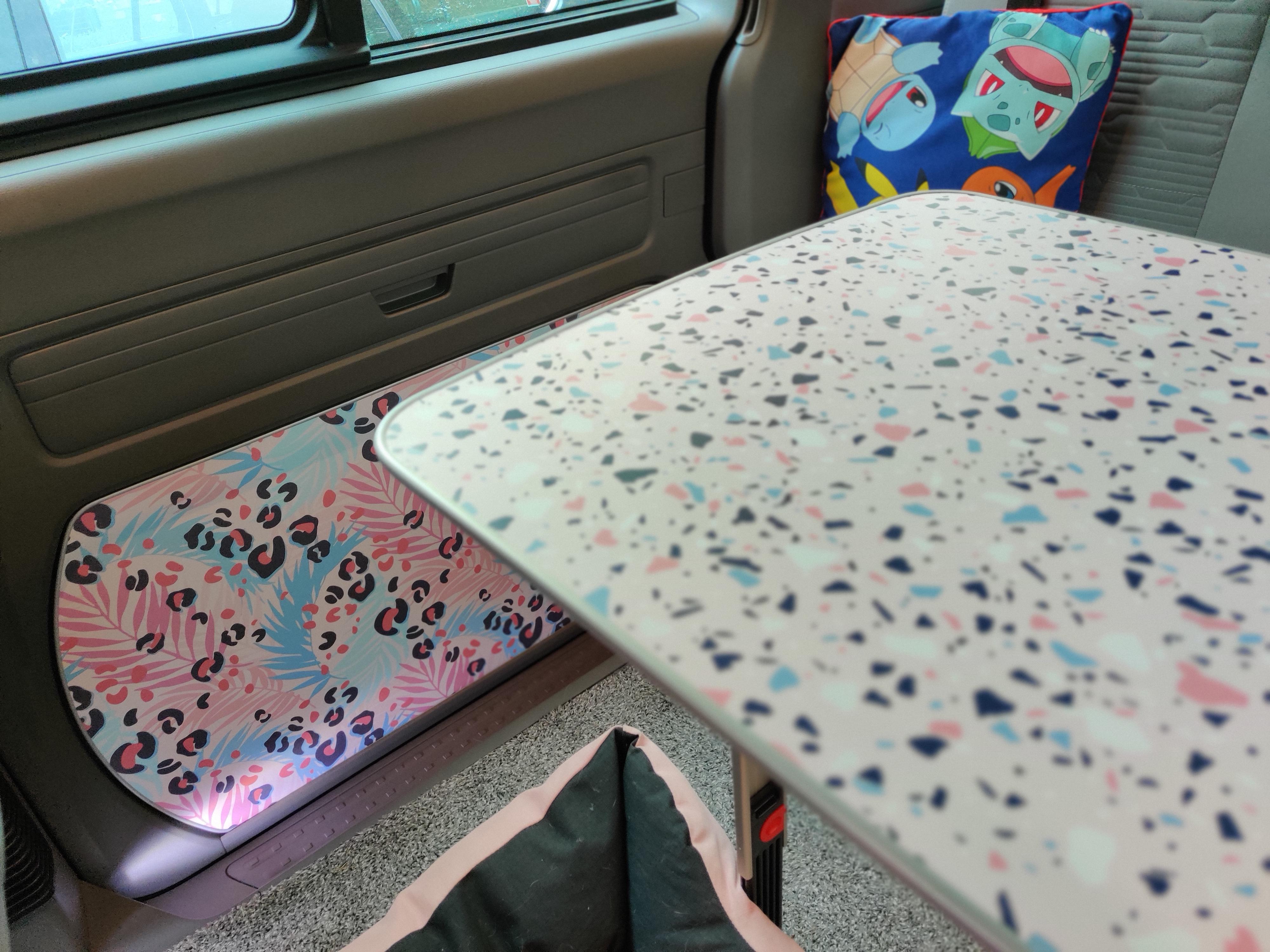

Excuse resurrection of old thread, but wanted to share our table wrap result inspired by previous posts and mention decorwrap as our source of vinyl (as pixers didn't seem to offer anything we fancied). Certainly happy with a splash of colour inside the van!
