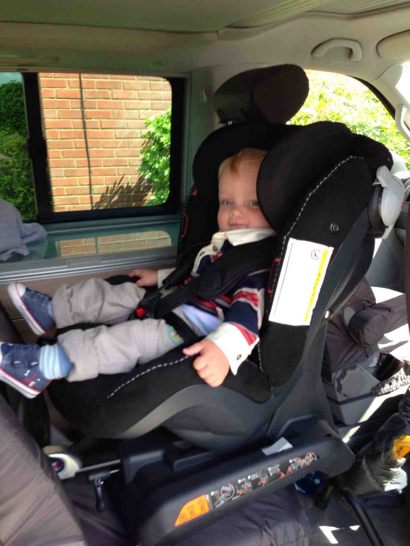

We've a rear-facing child seat, a BeSafe Izi-Kid isofix and I can confirm this fits in the rear. However it works much better in the 5th seat and I'd recommend this option to anyone. Note, it's not an infant carrier, but for children up to 4 years old (see http://http://www.rearfacing.co.uk if you think rear facing is a faff)
Ben loves his "Starship Enterprise seat" in the Cali
