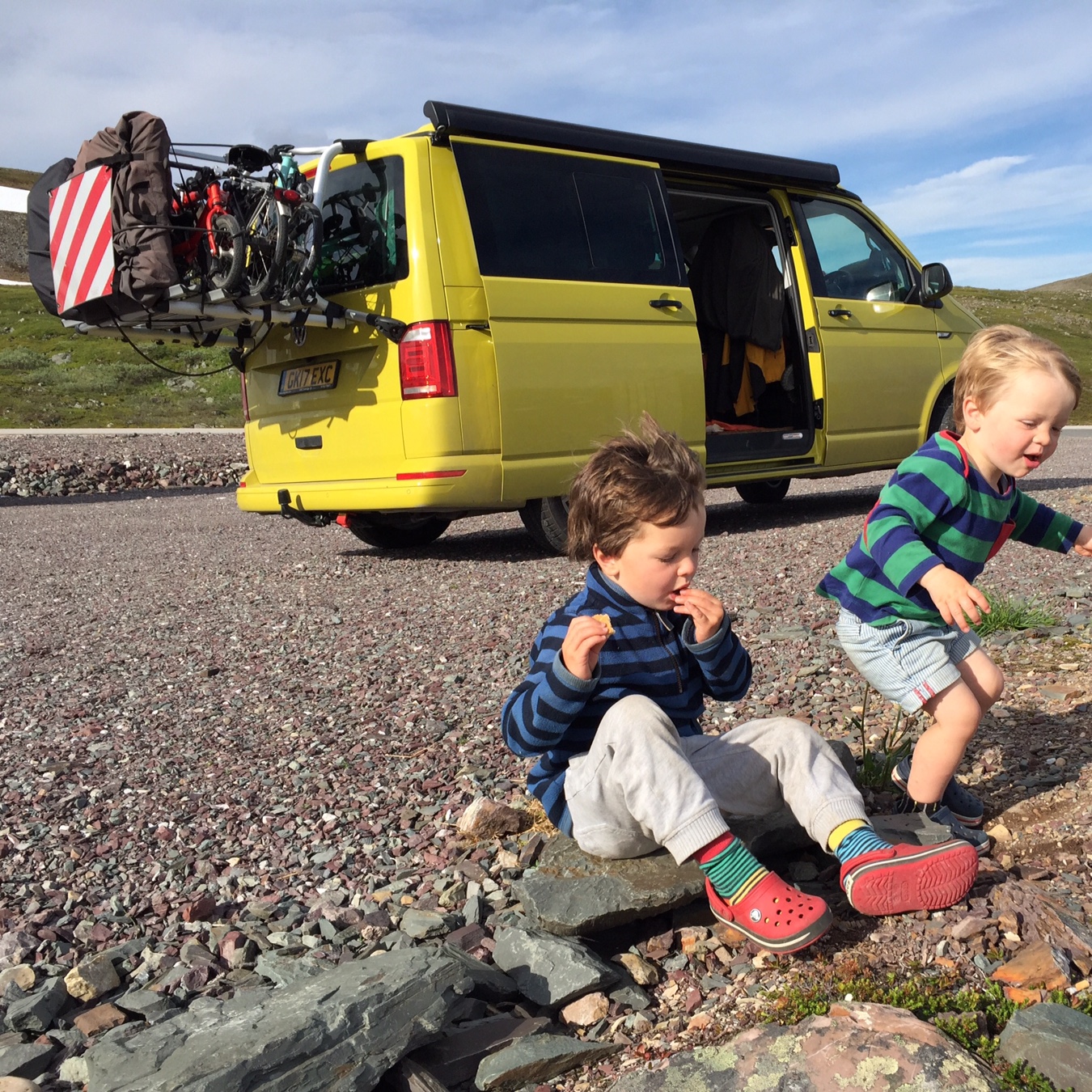

May I share with you my impressive rear end?
Four bikes and a double child trailer - all below 2m and within bike rack weight limits.

Similar system to the Ikea chopping board works for me on a T5 rack. Brackets made from some scrap aluminium scaffolding tubing etc and a local welder £5. Just below 2mtrs and great for carparks and toll 2m limits. Also roof up and tailgate open. I have tried covering them with a top end cover but as WG advises wind turbulence will shred them. I got around this by very tight strapping on the cover but one baggy bit and it'll be in shreds within a couple of miles of motorway driving.
These are my brim to brim diesel consumption figures with 2 x Brompton, 2 x children's toy bikes and a double bike trailer, all folded to below the roof line. My van is a 150 DSG Beach.
