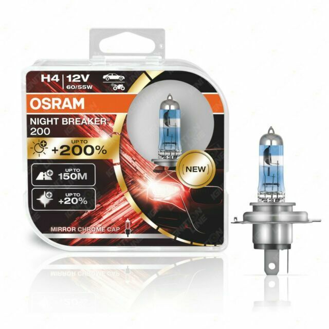

Latest law states that it is illegal to fit LED bulbs in Headlights that are designed for Halogen bulbs.
You can do it but not legally. MOT failure.
There has been tightening up on LED use due to dazzling effect.
Not tried these but the +150% were an improvement on standard.
bit of sales licence as 100% is what you have therefore 200% is a 100% improvement in real terms.
Example source
