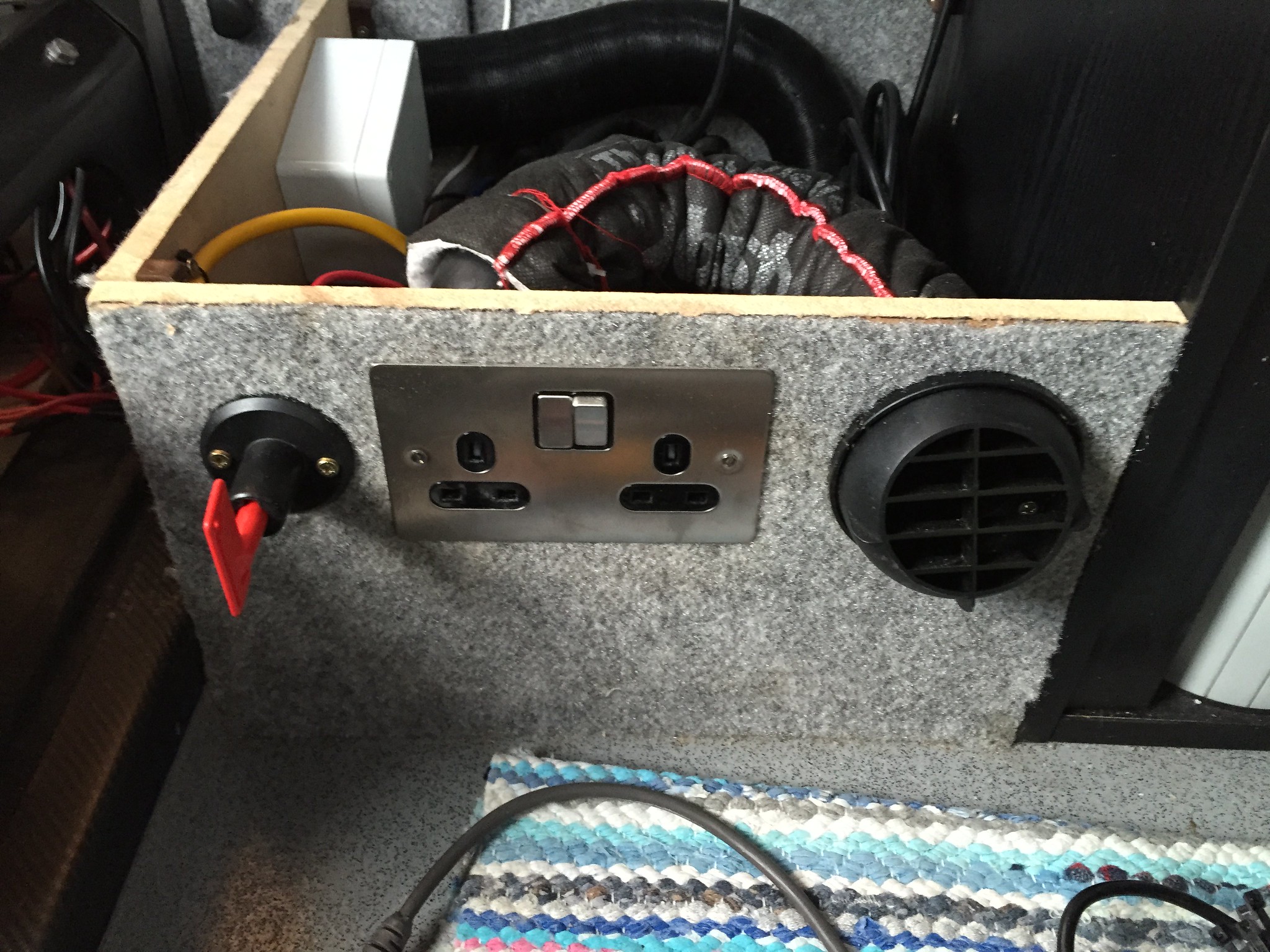

On my Syncro I fitted a big red isolator key switch which does the same in a more crude fashion. Maybe wouldn't look as nice on a cali.

Does the isolator on yours disconnect the leisure battery?
I’m hoping to fit a switch on the panel behind the drivers seat.

Aye this switch was just for the leisure battery. I took it from a diagram someone made. You can disconnect the lot whilst you are away from the van. It saved the van from fire when I was in Norway. It had an old 12v socket that shorted that wasn't fuses properly (previous owner) and almost went up in smoke! This allowed my to quickly pull the plug and save the van!
