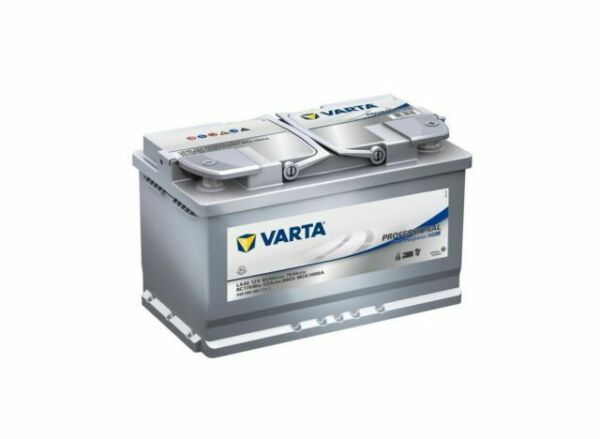

The good news is that you only only need one and they are very easy to fit (takes max 30mins ):
Good afternoon,
Almost 200 Euro for a battery :shocked , I hope they last for 10 years!

Hello Peter,
I should have know that they are expensive - everything to do with the California is rather expensive.
So far I have no problems with the batteries (touch wood). As soon as I have a bit more time I try to search here (and google) to see how long those batteries last (average).
