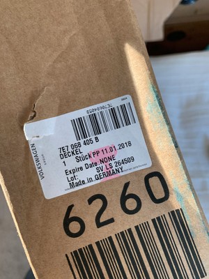

Is this the fridge top?
This is the table but as you’d expect t it’s expensive
Thank you for this link.
I am not sure about the fridge top. On mine I only find a number that looks like AEA 001780.
Why do you need a new lid?
Have you got a pic of the broken bit? It might help.
7H7 068 473 B about £100 from vw
