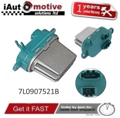

Climatronic Heater Resistor 7L0907521B ... Check your part no.
Thanks
I was looking at those and noted that Hitachi do one ..... I found the reference code on your thread but I thought I better take a look before ordering one.

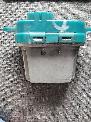

Well arrived. Fan was either on full, or low. Most certainly a resistor issue. Now I cant turn the fan off no matter what fuse I remove. I don't have small enough torx head either to unplug the fan....... wonder how long the battery will last?

Removed and replaced the resistor this morning and all seems normal again.
Bought the Hitachi one from AutoDoc
